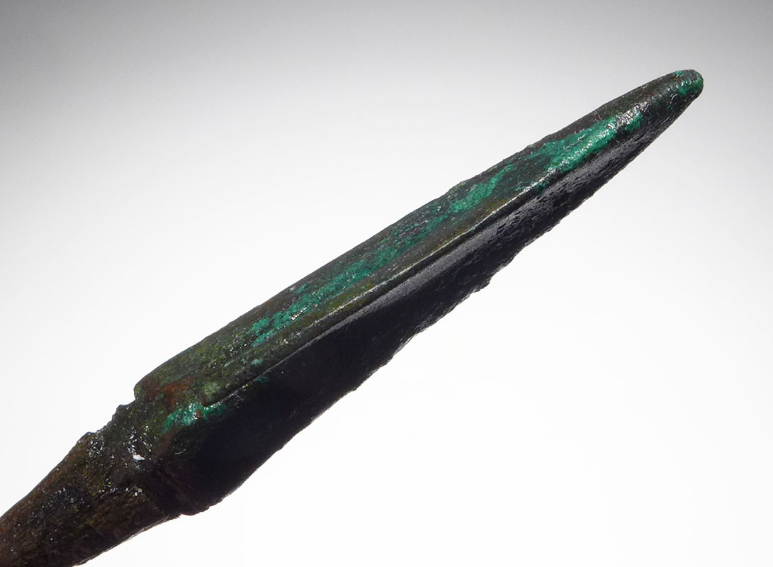

Here is a Mycenaean bodkin dating a thousand years before mail was invented.

We can discount the obvious war arrows with their "spearhead" and "duckbill" heads, which leaves byker heads, fitted to the only white goose fletched shafts as well as 5 small peacock ones (presumably for a younger archer) in their perfect sheaves of 24 and 48 arrows - not "old and feeble" or fletched with grey Goose feathers for heavy war arrows.
It's just my theory obviously but I think it matches the archaeology - we know what heads are in use in the 1420s and there's only about 4 types overall, and the most common found in civilian contexts are bullet shaped, round, pointy beak jobbies!
I think there are references to pile or pike arrows for shooting clouts and butts somewhere, maybe in Latin.

Pedro Paulo Gaião
Location: Sioux City, IA
Joined: 14 Mar 2015
Posts: 468
PostPosted: Sun 02 Nov, 2025 4:43 pm    Post subject:         Reply with quote
Interesting, I now realize why 14th-century Portuguese Wills, in general, often talk about "iron sabatons" and "steel gauntlets" at the same time, as if the material composition was important. Considering how hands and feet had different priorities, it makes sense using the best material to protect your hands and second-rate metal for your feet.
Froissart also has a kind of hyper-focus on Bordeaux Steel, mentioning in a number of times how English Mercenaries in Portugal and some French Mercenaries (apparently mostly were from the border regions) in Castile had spears from that region.
"Miles was created a knight by the souldich de la Traue, as being the most accomplished knight there, and the person who had been in the greatest number of brilliant actions. When the combatants were completely armed, with lances in their rests, and mounted, they spurred their horses, and, lowering their spears, met each other with such force that their lances were twice broken against their breast-plates, but no other hurt ensued. They then took their third lance, and the shock was so great that the heads of Bordeaux steel pierced their shields, and through all their other armour even to the skin, but did not wound them: the spears were shattered, and the broken pieces flew over their helmets."
https://uts.nipissingu.ca/muhlberger/froissart/roye.htm
This bear had killed four of his dogs and wounded many more, so that the others were afraid of him; upon which sir Peter drew his sword of Bordeaux steel, and advanced on the bear with great rage, on account of the loss of his dogs: he combated him a long time with much bodily danger, and with great difficulty slew him, when he returned to his castle of Languedudon, in Biscay, and had the bear carried with him.
By the way, on the dart issue: I was finding strange how many bishops and nobles' inventories and rolls feature so much prominent for "azcumas" (azcona in Castilian). Its often mentioned after swords and falchions, and donated to sons of nobles as if they were made to be important.
In fact, some gifts given by King Fernando to the Emir of Granada, around mid-14th century, where these azcumas:
"el - rrei dom Fernando [ ... ] enviou estonce [ ... ] trinta azcumas todas com contos e anguados de pratas dourados , que levarom quareenta e seis marcos de prata em guarnimento ?
My attempt to translate:
"The King D. Fernando [...] thus sent [...] 30 azcumas, all decored with golden plates on their butts and blades [?], that took 46 marks of silver in decoration"
Historians have this idea that Azcuma is likely a heavier sort of dart, and it appears in a number of 15th-century sources when nobles are hunting:
"And with the pig [likely a boar or hog] leaving, the Prince, not wishing to wait, threw [his ascuma]; a most beautiful azcuma-throwing wasn't seen or heared by mountaneers, because the blades of the azcuma entered into the thighs and cut through the bones and tendons; and the blade went out with all the shaft near the butt-end of the ascuma to the other side of the beast's back"
I immediately associated that reference with barbed style heads because of the hunting association (and we know there were barbed darts). Interestingly, the few darts that show their points in the Pastrana Tapestries are actually very big feathered weapons:
Perhaps "azagaia" meant a normal type of head, but I bet that were heavy darts like this that were the ones mentioned killing knights in full armor.
Pike arrows is an interesting one. Piked basically meant pointed so you can see it being applied to certain types of bodkin arrow, but it is such a vague term I doubt you could make that connection with certainty.
