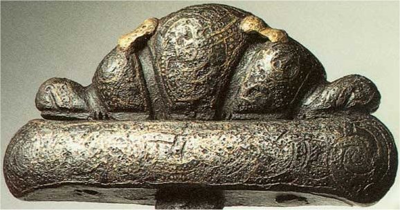

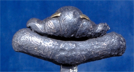

Does anyone has information regarding some parts made of yellow metal encountered on the upper part of some viking pommels ?
Was this only intended to secure decorative silver wirings or is it any other known (or supposed) purpose ?
I can only speak for those hilts īve personally seen (even if I suspect think this feature is the same on all those that share it).
These hilts are constructed with a U-shaped bar curving inside the hollow pommel cap.
The outer lobes depict beast heads in various degrees of simplification.
The narrow bands work like "staples" gripping arond the U-shape bar inside and at the same time might suggest ears or perhaps even horns on the beast heads.
In most cases there were also twisted wire in th grooves dividing the lobes on these pommels. These are often missing.
My guess is that some kind of pitch or resin was used in combination with these "staples", filling the inside of the pommel cap and upper guard.
This material would have melted away in fire burials and could also have been of organic nature and rotted away, perhaps. I know of no traces of such material surviving in a hilt today. It just seems like a logical, practical and simple solution.
Peter -
I like the concept, but confess I'm having trouble visualizing how one could get the staple wire to wrap around a u-rivet and come up out of the pommel without a joint on the outside - I've only seen one of these models up close, and did not detect any evidence of seams.
Got a sketch or X-ray to share?
Thanks,
Jeff
