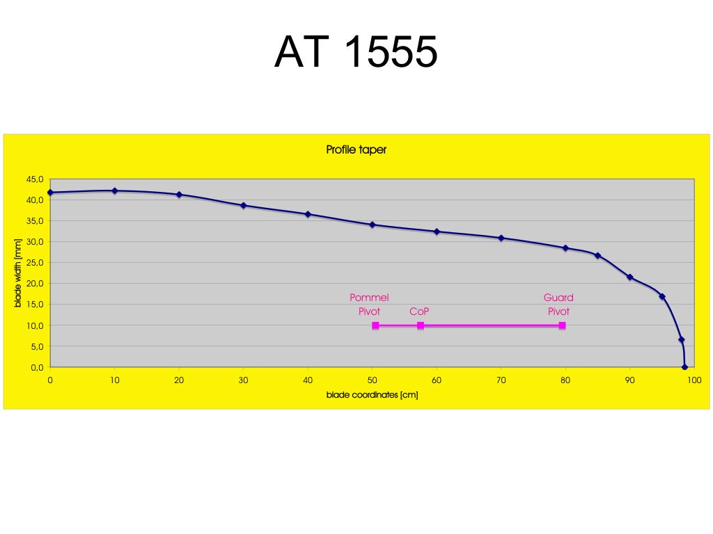

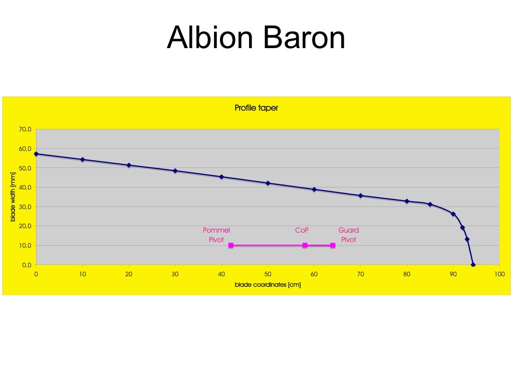

PostPosted: Mon 06 Nov, 2006 3:23 pm    Post subject: Some real figures         Reply with quote
This thread inspired me to add something more to the usual measurements I do with my swords. It took me some time, so am late in the thread, but perhaps still helpful.
I keep all my measurements in EXCEL sheets, which easily enables doing graphic representations. You can see in the two attached figures the measured profile taper of my Albion BARON and my AT 1555 sword (all figures are metric).
Usually I measure in addition CoG, CoP and the guard pivot. Inspired by Vincent's simple formula on how to deduct any pivot from a given pair, I experimented with measuring and tweaking the results to fulfill the formula. What you can see as the pink line in the graphs are both extreme pivot points (from pommel and guard), measured and deducted by the formula - so as close to the "truth" I can get. On the pink connecting line are all theoretical possible pivot points possible from the hilt. For illustration I have also marked the measured "Center of Percussion".
My first interpretation of the figures:
- CoP for both swords is within the pivot point line. I don't know if this is good or bad, or typical. Have to measure more swords to find out.
- The Baron has the pivot points surprisingly far away from the point. If the pink line is the zone for optimal cutting, it's as far behind as two thirds to half of the blade. But as an Oakeshott XIIIa the Baron is a great cutting war sword - no real surprise on that.
- The AT 1555 has its pivot points closer to the tip, like expected from a later XIIIa sword. This sword is more suited to elaborate techniques in bind, like winden or duplieren, which would happen around the guard pivot point.
So for a practitioner it's quite interesting to know about the location of the pivot points on his sword in order to use them properly. I might mark the "pink zone" with two rings of coloured tape on my training sword and try to wind within this zone Cool
I will repeat these measurements for my Albion Landgraf, which is a very pointy XII, and expect the pivot points to move even further to the point.
In this context I have a question to Vincent: is it possible that the guard pivot may be outside the blade, somewhere in front of the point? The formula allows it. What kind of dynamics would such a sword have?
Thanks for this really inspiring thread!
 Attachment: 46.46 KB
Pivot Points Albion Baron [ Download ]
 Attachment: 50.14 KB
Pivot Points AT 1555 [ Download ]

PostPosted: Tue 07 Nov, 2006 2:36 pm    Post subject: Re: Some real figures         Reply with quote
Hello!
There's no need to worry about being late, after all we're studying things from several hundred years ago here, so I guess we're not really in a hurry Happy
Yes, the formula is helpful because it allows to control the measurements. It's quite necessary since the "waggle test" is not absolutely accurate (it becomes exact when the back and forth motion has a high frequency), and not so easy to perform...
Apparently this seems to be the case on most swords, but I'm not completely sure of what it means. As I said I'm not advanced on the link between harmonics (COP) and dynamics (pivot points) so I would not judge a sword based on that...
The pink line is not necessarily the best part to cut with. Impacts involve more than just the sword, you have to at least take into account its motion and the mass of the target (that would be the crudest model). I've done a few formal calculations with that, and the area where the most energy is used for the cut (i.e. not for moving the target) moves to the tip when the target is lighter. Plus if you want to avoid vibrations you have to take the COP into account. Oh, and the blade profile, of course Happy So in the end you cannot really find the exact good spot for cutting, rather you adapt your cut to the circumstances. If during a fight you can make a cut that will dissipate 10% less energy but will still kill your opponent and would make you safer because you have 20cm more of reach, I think it's a wise thing to do...
The pink line is only the right place to cut at a target with infinite mass, hacking down a tree would be an example. But swords are not meant to do that Wink
Anyway in terms of placement of pivot point your Baron is quite close to my type XI, i.e. something adapted to be quick and powerful in cutting motions while sacrificing a bit of tip control. Moving the forward pivot point while retaining blade mass would result in a slower tracking in cut...
I don't really know since I don't have a significant experience with longswords, but from what I can see about the AT1555 your conclusion sound right.
If I may dare commenting a bit about this, I'd like to correlate the position of the pivots with what can be read in the review here. Seeing your figures, I was thinking that the pivot point of the pommel might be a bit further away than what I ordinarily like (so it's typically something personal and linked to one's style), something like 75cm away from the pommel if I'm not mistaken? This tends to slow the tracking of the blade a bit. And indeed in the review:
Caleb Hallgren wrote:
It doesn't accelerate in the effortless manner of a smaller, lighter blade. It takes effort to get it moving into a swing.
Which I take to mean that you have to put a good amount of torque with your hands, since pendular behaviour is not enough to sort of "bring the sword into the cut"... On the other hand, indeed the forward pivot point is close to the tip, which concurs with both your observations and the reviewer's.
All this shouldn't be taken as a criticism of the swords of course, but rather as a try to link dynamic properties in words to dynamic properties in measures.
Glad you like them Happy
I will repeat these measurements for my Albion Landgraf, which is a very pointy XII, and expect the pivot points to move even further to the point. In this context I have a question to Vincent: is it possible that the guard pivot may be outside the blade, somewhere in front of the point? The formula allows it. What kind of dynamics would such a sword have?
It's entirely possible, though it's not something that I think would happen with a sword meant for cutting. I have seen a wall hanger that had this behaviour once. In short, if you have a blade and you add a pommel too big on it, it will eventually move the cross's pivot point outside the blade. As far as I understand the effects of pivot points, it's not something you wish to do in general. Indeed it will:
* lower the tip control, since what you feel is not on the blade but beyond. In fact you're feeling a mass that is purely virtual and gives you no indication of the blade or tip position
* lower the blade mass. To bring the pivot point beyond the tip you have to bring the center of balance closer to the guard, thus diminishing blade mass even more. So not only you feel a mass that is not on your sword, but it's a small mass.
* it will also give a funny feeling for tracking in cut. In fact, when you add mass to the pommel, its pivot point does not move, so the pendular behaviour is still the same. However, you will feel like you'd want to grasp beyond the pommel on such a sword, because you can feel in your hand that gripping there would lower significantly the pendulum's length. In general, on swords meant for cutting, or quick rotating motions, I found that the pendulum length at the pommel is quite close to the minimum you can have on the sword. Moving this minimum beyond the pommel could possibly feel awkward.
You can get an idea of how it feels if you like, by gripping a stick very close to the center of gravity. Or you could add a big removable mass to the pommel on one of your swords... You'll see what I mean, I think.
In fact it's one of the problems I had with the article by George Turner, because he emphasized quite a lot that the pivot point of the cross should be at the tip no matter what. But trying to balance my type XI like this does not feel right (and would require a really big pommel).
Remember also that pivot points don't necessarily move together. It's possible that on your Landgraf, the forward pivot point gets closer to the tip, while the pommel's pivot point stays around the middle of the blade (I'm not saying that it's what should happen either, but it's possible)... There are really a lot of possibilities, depending on how the maker played with the pommel, tapers, proportions... That's the beauty of the thing Happy
Thanks for sharing!
