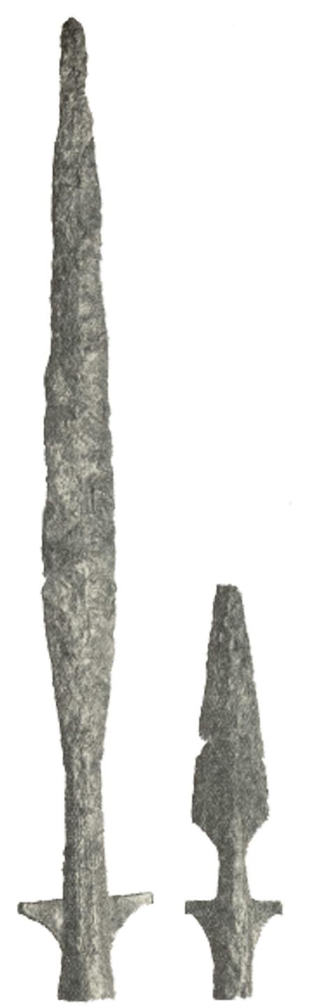

Attachment: 58 KB
Pettersen type D spear, 9th century, 1:1 [ Download ]
Attachment: 57.88 KB
Pettersen type K spear, 10th century, 1:1 [ Download ]
Attachment: 33.96 KB
Pettersen Type M spear, 11th century, 1:1 [ Download ]
