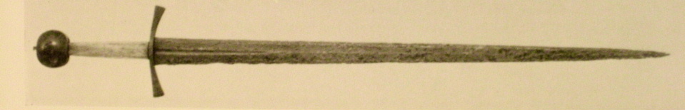

There is a similar sword in the Royal Armouries Tower of London (IX-1084). It has similar pommel (although the boss is smaller and does not have a recess) and similar cross. This sword is 107.9cm in length (overall). It has a small fuller in the upper 1/3 of the blade (like the Del Tin). the single biggest difference is the presence of the large side fullers on the Del Tin. The sword is dated to the fourteenth century.
Picture is included.

Posted: Sun 17 Apr, 2005 9:04 pm Post subject: Re: Does anyone know where the original one of these is? |
Alexi Goranov wrote: | the single biggest difference is the presence of the large side fullers on the Del Tin. The sword is dated to the fourteenth century.
If you look closely at the Tower sword, it looks to have 2 shallow fullers (or severe hollow-grinding) between the small fuller and edges.

Posted: Sun 17 Apr, 2005 9:43 pm Post subject: |
I don't know if those are fullers or if it's simply a strong secondary bevel at the edge. Even if it's the latter Fulvio may have interpreted it as a fuller. Either way I'd say this is a strong candidate Russ.

Posted: Mon 18 Apr, 2005 6:54 am Post subject: Re: Does anyone know where the original one of these is? |
Alexi Goranov wrote: | Russ Ellis wrote: | http://www.deltin.net/5149.jpg
Does anyone know where the original of this sword currently resides? I've already asked Mr. Del Tin about it and he himself does not recall. He believes that it might be in the Royal Armoury but was not sure... anyone? |
Alexi |
Alexi may I just say... NICELY done! I think you've got it. On a purely visual level it's darned close and combine that with Mr. Del Tin's clues about where he thinks he may have found the original...
I certainly appreciate it sir!

Russ Ellis
Posted: Mon 18 Apr, 2005 6:56 am Post subject: Re: Does anyone know where the original one of these is? |
Chad Arnow wrote: | Alexi Goranov wrote: | the single biggest difference is the presence of the large side fullers on the Del Tin. The sword is dated to the fourteenth century.
If you look closely at the Tower sword, it looks to have 2 shallow fullers (or severe hollow-grinding) between the small fuller and edges. |
Agreed. The picture is a bit rough but there definitely looks to be an edge bevel between the fuller/hollow grind and the edge of the sword.

Russ Ellis
Posted: Mon 18 Apr, 2005 6:57 am Post subject: |
Patrick Kelly wrote: | I don't know if those are fullers or if it's simply a strong secondary bevel at the edge. Even if it's the latter Fulvio may have interpreted it as a fuller. Either way I'd say this is a strong candidate Russ. |
Agreed!

Posted: Mon 18 Apr, 2005 8:28 am Post subject: |
I'm pretty sure that's XVIa.1 from RoMS.

Patrick Kelly
Posted: Mon 18 Apr, 2005 11:15 am Post subject: |
Russ Ellis wrote: | Allen W wrote: | I'm pretty sure that's XVIa.1 from RoMS. |
I'll check that out when I get home... |
I don't think that's it. I have the DT sword here now and it's far closer to the example that Alexi posted. The blade's cross-section and the guard style are much closer to that one.
Russ Ellis
Posted: Mon 18 Apr, 2005 8:40 pm Post subject: |
Well having looked at the picture of XVIa.1 I'd have to say that the cross is completely different then the replica although based on the pictures we have I couldn't say for sure that the Del Tin sword isn't an amalgamation of the two. The XVIa.1 does appear to have a not completely disimilar cross section although the central fuller is rather a lot longer then on the Del Tin sword. The pommels are pretty close as well between the two swords.

Joe Maccarrone
Location: Burien, WA USA Joined: 19 Sep 2003
Posts: 190
Posted: Wed 20 Apr, 2005 12:36 am Post subject: |
Interesting thread... I woulda sworn I saw a triple fuller in the pic Alexi posted, but -- Royal Armouries IX.1084 is XVIa.5 in RoMS. Concerning the fuller, Oakeshott writes:
"The fuller here is very narrow, but there is a distinct rib in the lower half of the blade."
No mention of a triple fuller. Now that I read that, I can see the rib, and either a secondary bevel, as Patrick speculated, or a hollow grind. I would think that Oakeshott would have mentioned the latter, so maybe it is a prominent secondary bevel on a blade intended primarily for thrusting. Either way, an appealing sword, which Oakeshott dates c.1300-25.
Edward Hitchens
Posted: Wed 20 Apr, 2005 6:50 pm Post subject: |
I don't know, fellas. I've got my copy of Records right here in front of me (type XVIa.5), and Oakeshott has the blade at about 84 centimeters; according to Nathan, DT's website has their replica's blade at 91, right? Oakeshott also says there's a "...distinct rib in the lower half of the blade." Looks to me like the original has a pommel nut as well.
