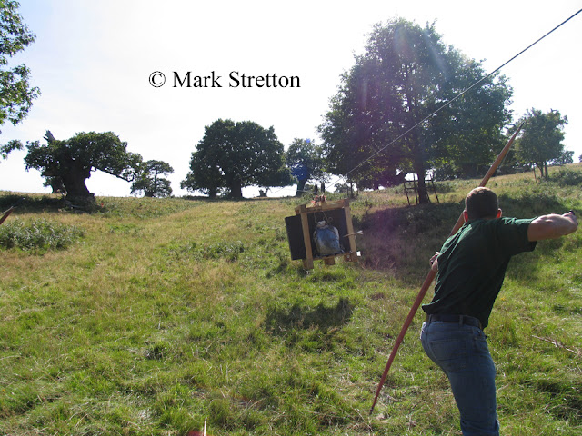

The nearest that i can recall was Mark Stretton's tests with his motorized charger.
How Effective is an Arrow Against a Charging Knight?
Does an Advancing Target Increase the Combined Impact of an Arrow onto Armour?
While his test armour is notably in the lower end, being 1.6mm of medium carbon steel and its also facing the perfect storm of heavy arrows at point blank from a high power bow.
Joe Gibbs shooting at really too close for comfit.
Only a minority archers would be in a position, be ready and have the nerves to take that single shot.
Thanks, that is really cool. It is interesting how even a test that is not the highest quality can provide some useful insight. There is the trade-off between shooting fast or shooting accurate, and even though it wasn’t a real knight, the archers felt pressure, and there is also the learning curve. I don’t think that is anything one can learn from shooting at a butt on Sundays.
