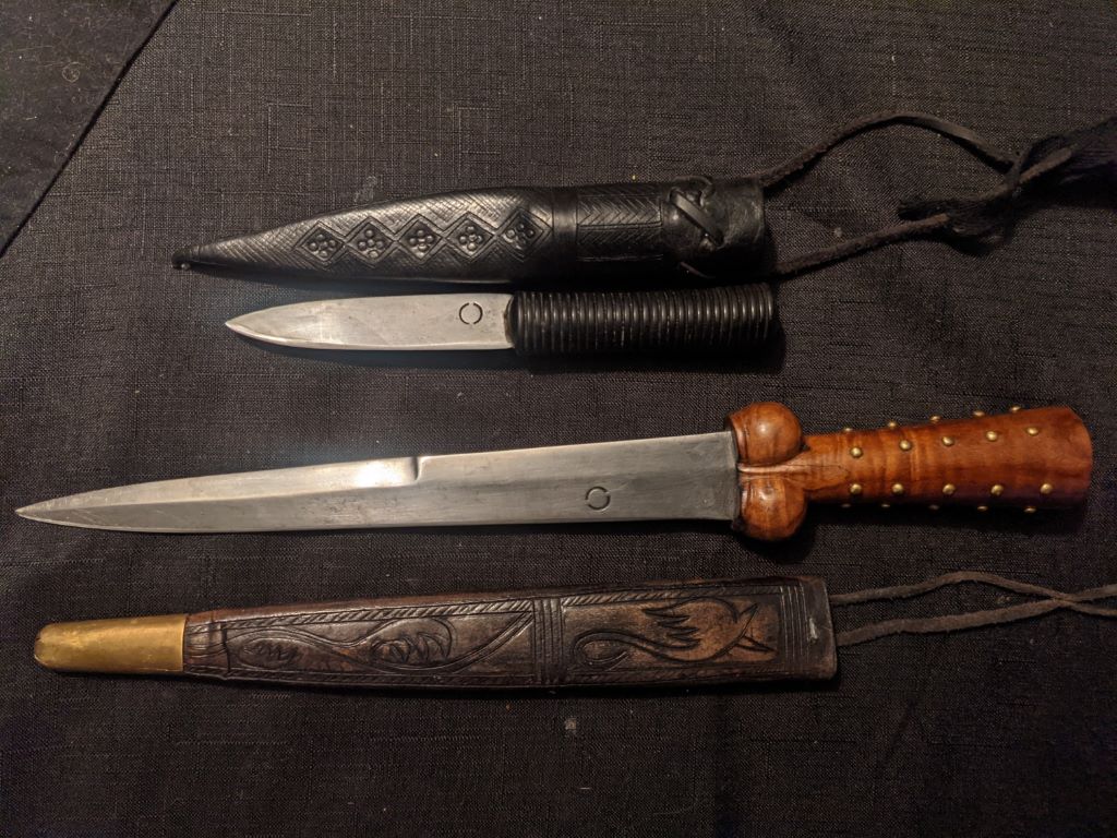

I'm not sure what was actually done historically, but I can account for my personal upkeep using historically available materials- I'm using Tod Cutler knives, my main eating knife and bollock dagger being in use since 2019. Granted not a long time, but should be enough to show wear. YMMV with different metal compounds of course.
Our group mainly does camping events, plus a week long backcountry camping trek in 14th century kit, so knives get both heavy use and exposure.
When in use, I find just wiping off the knife with a rag after eating spreads grease from the foods over the metal and handle keeps rust well off. If it's feeling a bit dry I'll add some grease from cooking or olive oil. If it does start to get a bit nasty or threaten to rust, putting some ash on an oiled, buttered, or otherwise greasy rag and polishing the blade with it does a surprisingly good job.
When I get home, I'll wash my eating knife with the rest of my dishes, and give it a coat of olive oil to live with, and it'll be good until the next time it's needed.
I think the trick with olive oil may be to have quite a thin layer- there certainly should not be and build up. A wipe with an oiled cloth will do.
They have a darker spot or two, but overall quite clean.
I'm positive a knife blade could have been kept quite shiny in period, but it would definitely require dedication and people hours.
