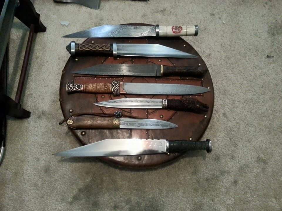

PostPosted: Sun 10 Mar, 2019 8:10 pm    Post subject: Seaxes         Reply with quote
Sunday night Seax Porn
cheers
 Attachment: 76.96 KB
Mark Moore
Joined: 01 Oct 2003
Posts: 2,294
PostPosted: Mon 11 Mar, 2019 12:27 pm    Post subject:         Reply with quote
Those are all very nice, but I like the middle one a lot....."Mr. Grumpy Face". Laughing Out Loud ............McM
