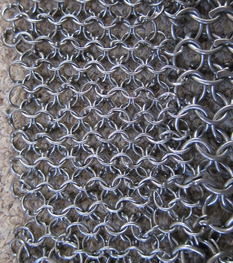

Never mind, I found that photo. It seems it must be of 'my shirt'; I had two at the same time, but the other was more the standard Ottoman sort. I might post some photos of it, since it has a number of amusing features.

Never mind, I found that photo. It seems it must be of 'my shirt'; I had two at the same time, but the other was more the standard Ottoman sort. I might post some photos of it, since it has a number of amusing features. | James this is a very interesting mix of different types of mail. Just to be sure which shirt is this one?
What is going on here, I am guessing that the flat solid links are repairs but how did they get inserted? I see some butted links but there are riveted links going through the solid ones as well.

Posted: Mon 27 Jun, 2016 2:11 pm Post subject: |
I'm presuming the lighter looking mail, which appears to be all-riveted, are the sleeves. If so, we have a demi-riveted body which might be Turkish, with all-riveted sleeves, which might have been European. Additionally, there are some notable repairs.
Or perhaps not.
I gather this is an armpit from the 90 degree join at lower left? If the rows are oriented in the usual way, the lighter mail would be an added strip beneath the sleeve, perhaps to make the shirt fit a larger girth, and the underside of the sleeve would lay at the bottom left corner. The only other explanation for the join is that the lighter mail forms the collar, which seems counter-intuitive.

Posted: Mon 27 Jun, 2016 4:51 pm Post subject: |
All the Ottoman photos are in my last post. All the others are of the heavy shirt. I think Mart is right that the lighter, all riveted, links are the sleeves. The links in the sleeves were just lighter versions of those on the main body, and clearly (to me, at least, who had his hands on it) original parts of the shirts. Look carefully at the hole, and you will see one of those really thick not quite round repair links second from the left. When it comes to the collar on the heavy shirt, it seems to me that a collar could have conceivably been a hood once upon a time. Just sayin'.

Posted: Mon 27 Jun, 2016 7:19 pm Post subject: |
This is clearly an all riveted collar added to the Turkish shirt. -

Posted: Mon 27 Jun, 2016 7:29 pm Post subject: |
| Eric S wrote: | What is going on here, I am guessing that the flat solid links are repairs but how did they get inserted? I see some butted links but there are riveted links going through the solid ones as well.
I think all of the flats have been punched from sheet, with both the center and outer puch being driven from the same side. This causes the solid rings to cup, like a shallow bundt cake pan. The last 6 rows have been woven with the solids turned cup-side up, while the rest of the shirt has been woven cup-side down. It probably is caused by adding a patch of mail woven the opposite way that the primary maker weaves his. When I'm making mail from half-solids, I try to keep them all cupped the same way to give a uniform appearance, and because I'm anal about stuff like that.

Posted: Mon 27 Jun, 2016 7:43 pm Post subject: |
James,
So the "heavy" shirt is of demi-riveted construction in the body with wedge rivets, and the sleeves appear to be of similar workmanship, though they're lighter and all-riveted?
It sounds like a shop where different sections are working on different parts of the shirt using different rings, but it's assembled as a whole within the overall business. This is very similar to what I was observing with Wade's shirt, though his was all riveted.

Posted: Mon 27 Jun, 2016 8:25 pm Post subject: |
That sounds pretty plausible, seeing as a shirt wasn't made by one man, anyway. I'm still trying to puzzle out the switch to all riveted on the arms, though. You'd think they only had one set of punches for the solid links!

Posted: Tue 28 Jun, 2016 8:12 am Post subject: |

Mart, you are way better at figuring out things like this than I am, my eyes get blurry trying to decipher messes like this. Did they just use new riveted links to fill a hole, with the cupped solid links added as filler?

Posted: Tue 28 Jun, 2016 7:40 pm Post subject: |
| Eric S wrote: | | Mart Shearer wrote: | | I think all of the flats have been punched from sheet, with both the center and outer puch being driven from the same side. This causes the solid rings to cup, like a shallow bundt cake pan. The last 6 rows have been woven with the solids turned cup-side up, while the rest of the shirt has been woven cup-side down. It probably is caused by adding a patch of mail woven the opposite way that the primary maker weaves his. When I'm making mail from half-solids, I try to keep them all cupped the same way to give a uniform appearance, and because I'm anal about stuff like that. |
Mart, you are way better at figuring out things like this than I am, my eyes get blurry trying to decipher messes like this. Did they just use new riveted links to fill a hole, with the cupped solid links added as filler? |
I don't think they added individual rings. I think it's basically an entire, rectangular patch which was added, albeit "upside down". I've marked the ayyachment so the red box has cup-up solids. I'd bet the area in green's solids are identical, but woven cup-down.

Eric S
Posted: Sat 02 Jul, 2016 7:03 am Post subject: |
| Mart Shearer wrote: | | Eric S wrote: | | Mart Shearer wrote: | | I think all of the flats have been punched from sheet, with both the center and outer puch being driven from the same side. This causes the solid rings to cup, like a shallow bundt cake pan. The last 6 rows have been woven with the solids turned cup-side up, while the rest of the shirt has been woven cup-side down. It probably is caused by adding a patch of mail woven the opposite way that the primary maker weaves his. When I'm making mail from half-solids, I try to keep them all cupped the same way to give a uniform appearance, and because I'm anal about stuff like that. |
I don't think they added individual rings. I think it's basically an entire, rectangular patch which was added, albeit "upside down". I've marked the ayyachment so the red box has cup-up solids. I'd bet the area in green's solids are identical, but woven cup-down. |
Thanks Mart, much easier to visualize like this.

Posted: Sat 02 Jul, 2016 10:30 am Post subject: |
Just for the newbies, I should point out one of my favorite details, the fake riveted rings. I keep running into these things on the stuff that comes out of Africa. The heavy shirt has none.

Eric S
Posted: Sat 02 Jul, 2016 11:44 am Post subject: |
| James Arlen Gillaspie wrote: | | Just for the newbies, I should point out one of my favorite details, the fake riveted rings. I keep running into these things on the stuff that comes out of Africa. The heavy shirt has none. |
James, do you mean the fake riveted links that the whiter arrows point to? Between you and Mart I feel like a blind man or half blind at least.
So were these repair patches inserted into the hauberk using butted links or riveted links? It sems like whoever repaired it just reached into a bag of assorted links without worrying about how it would look.

Posted: Fri 15 Jul, 2016 8:22 am Post subject: |
I should check in more often!
| Quote: | | James, do you mean the fake riveted links that the whiter arrows point to? |
The 'white arrow links' are all real. There are not many of the fake riveted links I was talking about in that photo, and mostly their back sides, at that. Look at the others from my post of June 27.

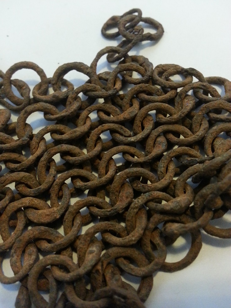

Posted: Mon 05 Dec, 2016 9:37 pm Post subject: |
My own humble little mail fragment:

Posted: Mon 12 Dec, 2016 8:00 pm Post subject: |
That's really cool Craig! Tell us more, where did you get it, what time is it from, what do you notice about this kind of construction. I'm envious you are starting an antique collection...

Posted: Tue 04 Dec, 2018 5:52 am Post subject: |
I got a little more info on the flattened mail. It's labeled Alskogs Ka (Alskogs Kyrka) which is in Gotland. Gotland is where the flattened Tofta mail coif is from.
