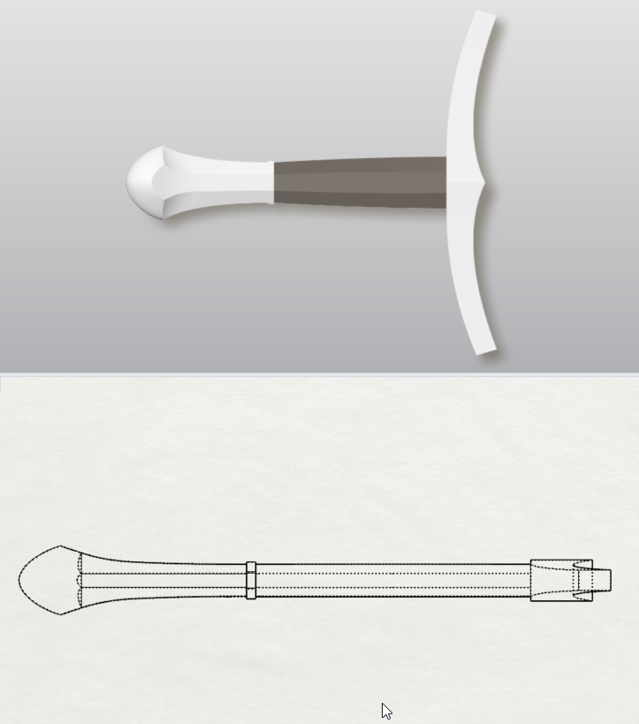

PostPosted: Wed 14 Nov, 2018 4:01 am    Post subject:         Reply with quote
I chose an hexagonal grip/pommel profile and this is what I came out with.
A lot of the grips seem very thin in the historical examples. Is this to compensate for wearing gauntlets?
How do the dimensions look, I wanted a little bit extra, but not too much.
(I am designing larp weaponry to be made with modern resins)
 Attachment: 36.96 KB
