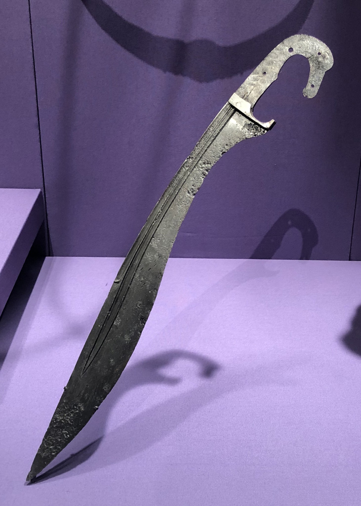

Interestingly, the Met has put this on display and changed the online writeup. They acknowleged the modern handle scales, said that the old patina was stripped off, but basically said, Yeah, we still think its real.

In museum speak the term "patina" is sometimes used to describe anything coating the outside of an artifact. I wonder what they think was removed as it was removed before they received the piece.

Hi all,
It's weird to pop on here and see people discussing an object I've worked on.
This falcata was looked at with a healthy dose of suspicion for a long time, but there has been some very good research done on swords of this type in the past few years, and Pierre Terjanian felt our falcata might be the real deal (well, not that horrible grip). Stylistically speaking, the shape of the blade, and the distinctive fullers are spot on. We x-rayed the hilt, and examined the metal to determine methods of construction. The material and method used to forge the blade, as well as the method of cutting a small notch in the tang to aid in forming the 'horse head', all checked out.
It's important to point out that these key features have only been discovered and published in the past decade or so, long after the object entered the Morosini collection (the donors) sometime prior to 1908.
Long story short, we are all confident we have a genuine falcata.
We have since removed the grip scales so that our visitors can appreciate the silhouette of the horse head. The removed scales and pins have been retained in storage.
Unfortunately, we were not able to get a new photograph for the website before the sword needed to be installed, but we plan to have new ones taken in the near future, along with the other objects that didn't make it to photography. I hope this image suffices for the moment.
If you guys are interested in learning more, I suggest reading Janet Lang's article Iberian Falcata in the British Museum (2010)
Note: the over-cleaning and grip predate acquisition
I hope this helps.

Thanks Sean so much for this good news and information! It looks even more impressive with the tang revealed, I think. I wonder what the original handle looked like?
