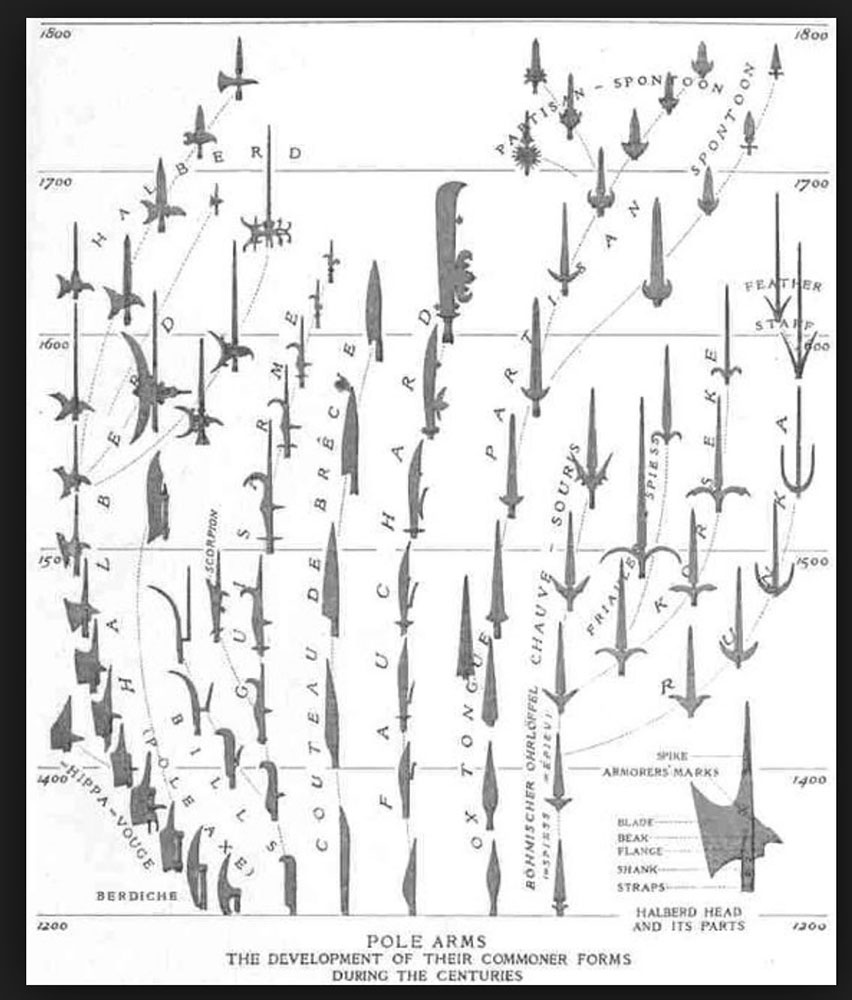

PostPosted: Mon 05 Dec, 2016 9:00 am    Post subject:         Reply with quote
Sounds like the copper head could be a souvenir of somebody's service in the Belgian Congo.
As for dating--what I'm seeing on this type (including that 1688 French wreck) suggests late 17th or early 18th c.
The cross-bar type (see below) seems to be common by mid-18th c., but I don't know if that's true for all of Europe.
It seems reasonable to date yours 1650-1750, with the sweet spot in the last quarter of the 17th c.

Posts: 5,940
PostPosted: Thu 15 Dec, 2016 7:33 am    Post subject:         Reply with quote
Here's a little more information for you, Beth.
