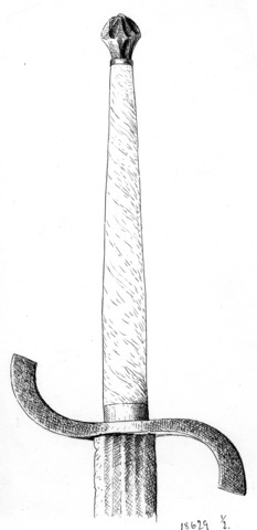

There is one more type of curved cross which I have seen on just one example from Norway... instead of a C-guard, we have an S-guard!
http://www.unimus.no/arkeologi/#/detailsView?search=C18629
it is quite similar to other swords we have already discussed In all respects apart from the guard: the pommel is the common, small, type T; the grip is very similar to D 787 above, with the smooth wood surface and metal capped end; the blade is large and multi-fullered (type XX?) like several of the kringel and halv-kringel blades, D4445 from Hinge Sø seems particularly similar.

About the norwegian S-guard sword. Totally agree that beside Hinge Sø (D 4445) the multi-fullered-blade also looks like many of the pretzel swords (for instance Tude Å, the Norwegian C13815 and the Swedish Swedish Army Museum, AM.060638).
The type of S-curvature on the Norwegian sword also looks a lot like the s-curvature on the Tingsted Church painting, though these blades seem shorter [the curvature of the S follows the plane of the blade edges on the Scandinavian ones, whereas the Dührer and the Higgins armoury example the S-curvature turns away from the plane of the blade-edges !!].
I would also agree they look like Oakeshott Type XX blades with regard to the fullers, but I have a suspicion that the blade geometry differs. The Scandinavian swords looks "convex", don't they? [meaning thickest at the blade center].

So far I have not been able to find a clear example of a Pretzel sword from a Danish church depiction, but this is the closest match I have found so far.
We have multi-fullered blade. [Shame that damage to the painting has removed the last part of the blade].
We have a ball pommel.
We have a thick two-handed grip.
and a very thick and short looking cross-guard, so I wonder if this is the artist's attempt of showing a pretzel sword.
The image also shows a small rain-guard.
So is this a pretzel sword? - it certainly fits in the other categories, where it looks very much like the "787" from Nationalmuseet.
Image of Matthæus with sword is from a church in Jutland - Udbyneder Kirke.
Dating is 1490-1510. So also fit with the time period.
Other guy is Bartolomæus.
 Attachment: 116.54 KB
Matthæus with sword.
Udbyneder Kirke.
Dating: 1490-1510.
Source: http://natmus.dk/salg-og-ydelser/museumsfaglige-ydelser/kirker-og-kirkegaarde/kalkmalerier-i-danske-kirker/
Mark Lewis
Joined: 19 Apr 2014
Posts: 382
PostPosted: Sat 23 Jan, 2016 5:19 am    Post subject:         Reply with quote
This is a great example, your searching has paid off! Is it the first depiction of the multiple fullers that you have found in the frescos?
The cross is a little puzzling... I know one of the museums holding a pretzel-hilt (forget which) claims that the pretzel-hilt was a later replacement to the original cross. I don't know what the basis of that claim was, but maybe this fresco is a clue in that direction also.
I was going to say that it was odd to see Matthew depicted with a sword (which is usually the attribute of St. Paul) but it is apparently a known variant in iconography.
http://www.christianiconography.info/matthew.html
