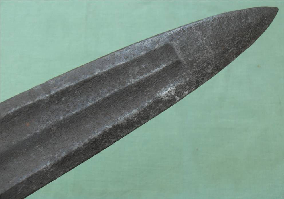

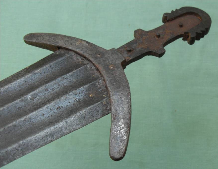

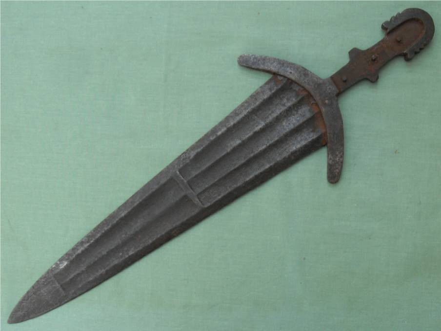

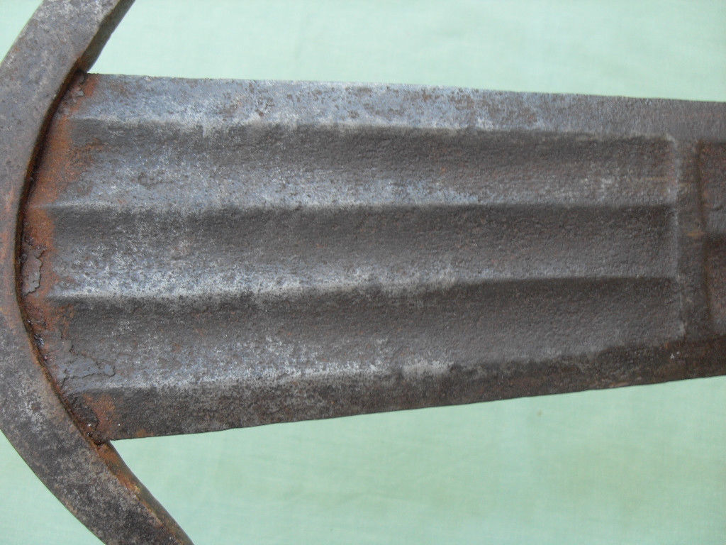

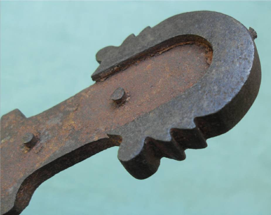

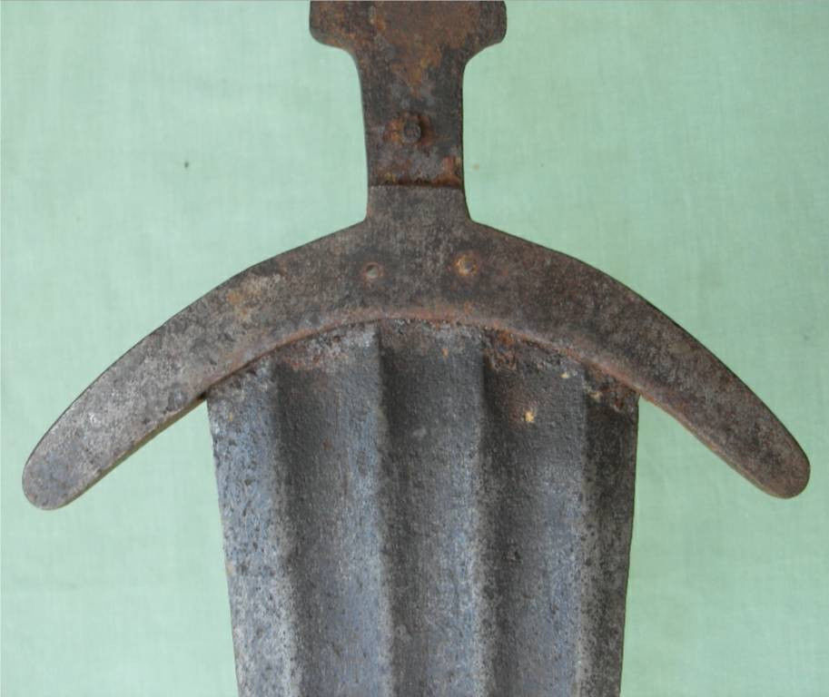

Hello Everybody,
I bought this cinquedea on eBay recently. The seller, quite honest, described it as probably 19th century and "possibly earlier". I bought it because it was so well made and nicely antiqued in appearance, but with the resignation that it was in fact probably no earlier than Victorian. Unfortunately, I got into a bidding war with another bidder (the Seller told me the underbidder was from Italy!!) and ended up paying way too much for a Victorian copy. In any event, as I said it's very well-made (note the fullers) and try as I might, I can't find similar 19th or 20th century repros/historismus examples with this kind of good fuller work in auction catalogs (Czernys, Bonhams, San Giorgio, etc) or online. Moreover, the cinquedea totally lacks any remnants whatsoever of the etching/inlays that cinquedeas are known for. I'm thinking that anybody putting that much effort into a repro cinquedea would at least attempt to copy some period etching. In short, I'm wondering if in fact it could be genuine c. 1500 without the embellishment one sees on most published examples. I totally admit I may be in denial and just wishing on a star here since I paid too much money...
I'd be interested in hearing your opinions.

PostPosted: Tue 11 Nov, 2014 2:14 pm    Post subject:         Reply with quote
I can't add any expertise or experience to your situation, but the second last image is interesting. The patina is a little more worn away on the ridge lines between fullers more towards the hilt, makes me wonder if this could be from a scabbard rubbing away and having a minor polishing effect.

PostPosted: Tue 11 Nov, 2014 3:32 pm    Post subject:         Reply with quote
Thanks Nat. That's an interesting observation. I hadn't noticed that. If that's true, it might point to it being earlier than 19th century. I should say here that one of my biggest reasons for originally agreeing with the Seller's 19th century dating was because the exposed edges of the hilt in this photo looked a little bit too sharp, too perfect a 90%, like they were machined, to be c. 1500 work.

Judging from the lines and the type of rust my gut is telling me its not original, but it must have been very beautiful in its time etching or not.
Kindof like an Albion in 800 years, to perfect to be original, but a beauty of CNC carving Wink.

I'm personally of the opinion it's a 20th century reproduction made by WIndlass.
Edited to add: I should have looked at the whole topic. Thank you for adding the photo. Before it was aged it was ground to be more convincing. I used to own one of these. Mine didn't have that cut-away grip around the lug area as it's being called here and it had three pins. It also had a riveted guard which always annoyed me. The same tang/grip slab mechanism and placement seals the deal for me. I wonder if I have an old photo of it.

PostPosted: Thu 13 Nov, 2014 3:12 am    Post subject:         Reply with quote

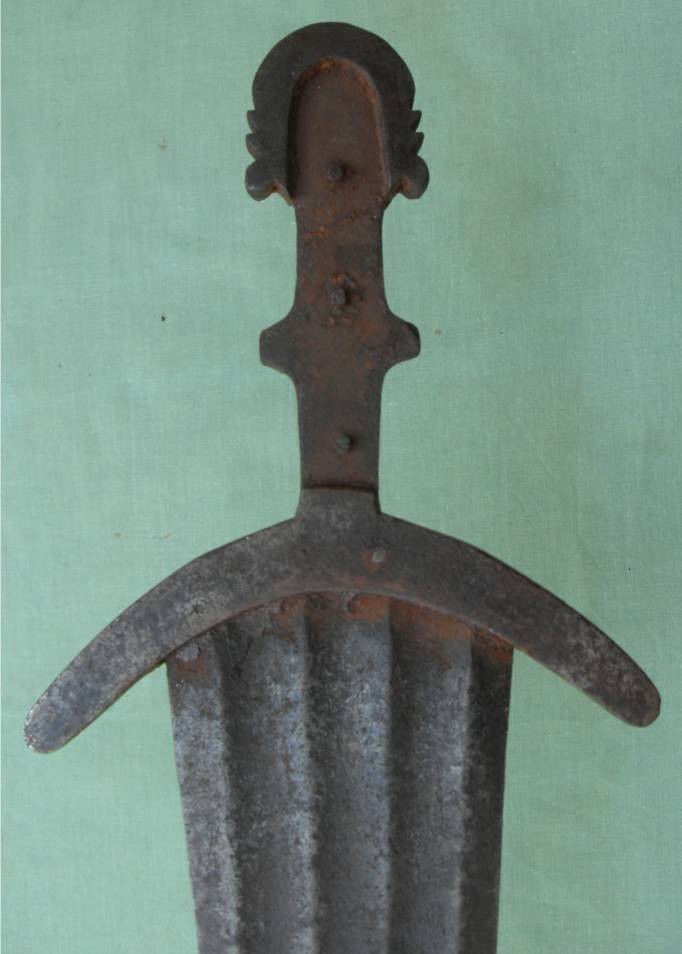

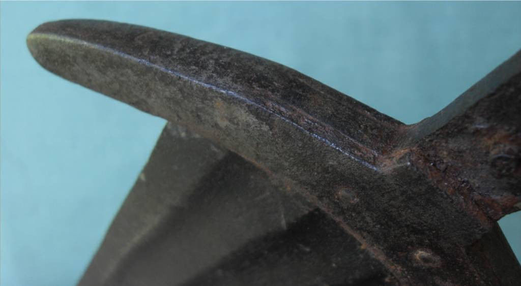

They're not the same - look at the modern one - the quillon/scale join on new one is rounded but on the 'old" one its straight across.. Also, look at the oblique close-up photo of the quillons - there appears to be 2 rivets going through the quillon just below the tang. And, - maybe it's just an artefact of corrosion - but am I seeing the faint outline of another rivet on the TOP side of the quillon, roughly in line with the outside edge of the fuller ? Also, the new one has 2 pins in the grip, 3 on the old one
It's quite possible this is a 19th C reproduction, and both it AND the new version are based on the same original ?

PostPosted: Sat 06 Dec, 2014 11:56 am    Post subject:         Reply with quote
I really don't think this is a Windlass piece, or at least not this particular Windlass piece.
The shape of the grip is entirely different even aside from the number of rivets, the proportions and shape of the guard are slightly different even beyond the "lug", and the pommel is also different in overall shape and a number of details. What's more, these aren't the sort of differences you'd see resulting from mere manufacturing inconsistencies, and I can't see them being the result of deliberate modification, either, as some of them would require you to add material in places.
Of course, this doesn't mean it's not a modern reproduction - possibly even a somewhat different model from Windlass, although personally I rather doubt it - but I'm quite confident it's NOT the model posted here. Maybe if Nathan finds a picture of that other one he used to have, it might match, but as far as I can see this one does NOT.

PostPosted: Sat 06 Dec, 2014 11:59 am    Post subject:         Reply with quote

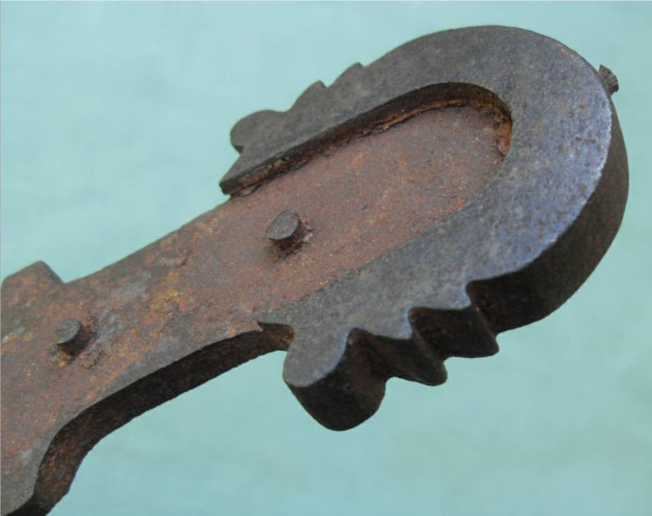

Riveting was a way to secure a broken tang that was welded to the blade after being broken, so it is not unthinkable that some smiths did the riveting through the guard to secure a bad fitted guard. Even if it is not something we have seen on surviving examples, it is not something that screams "MODERN"...

PostPosted: Sat 06 Dec, 2014 12:47 pm    Post subject: Re: Historismus Cinquedea         Reply with quote
Eric Feder wrote:
I'm just curious though as to why somebody would go to such lengths to create a decent repro in terms of the blade (and it IS decent looking) yet rivet the cross guard instead of just fixing it some other more historically accurate way. Were none of the originals riveted?
Some were, certainly. For example, the late 15th Century blade posted in this thread has rivet holes very much like your's.

PostPosted: Sun 07 Dec, 2014 2:03 pm    Post subject:         Reply with quote
As far as I am aware the guards were riveted in place originally. The grip tang was often far thicker that the blade and so the guard can not be slid down from the pommel end and so the only option is to slide it up the blade and set it against the tang or scales. There is then nothing to stop the guard sliding back off, as the grip does not hold it like conventional swords/daggers, so rivets were used. The ones I have examined had the rivets widely spaced toward the outer shoulders of the blade and structurally this makes more sense than having them close to the grip. These swords are usually very well made and the fit between the blade and guard is so good (presumably hot fit) that at first glance looking down from the pommel the blade and guard often look as one and likewise the rivets are so well set and dressed back that they take some hunting to find.
If those rivets are the only ones then I would question this piece, as it would be stronger and support the guard better to have them far out from the grip and so if there are two rivets I would expect them further apart. If there are other well dressed rivets further out in addition to these two then I would not be concerned with there being rivets.

PostPosted: Sat 20 Dec, 2014 2:23 pm    Post subject:         Reply with quote
Mikko, Luka, Daniel, and Leo,
Thank you all very much for your insightful comments! Leo, it does appear that there are only the two centrally located rivets present so in that regard I guess it argues against it being an original. On the other hand, Daniel, your comments gave me a bit of hope! As you said, at worst I have a very well made repro. And a nicely aged one for that matter. Wink Wink
