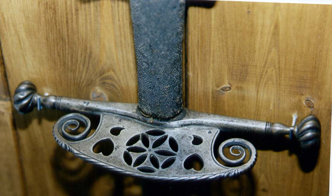

It was described quite well on HH website, but there are some things that are not clear to me:
1) How is the plate attached to the cross-guard. Description say it is "riveted". Does it mean that there is a slot along the cross-guard, the plate is pressed into it and then riveted to secure? that looks like the sturdiest way of attaching it, but I see no signs of rivets on the guard from the top view. It could have been riveted below the cross-guard, but again I would expect some signs of rivets on the top. The third possibility is that the rivets are integral with the plate, and do not go trough the cross-guard from up - down ("vertically"), but from front to back ("horizontally"), maybe combined with a shallow slot... a real mystery.
2) It seems that the plate is not reinforced on the front side - no thicker "fold" or border is visible, and the description is not mentioning it (it says that the front edge is "finely roped", but that could be done without thickening the plate). However, that would mean that the coiled sides would be quite weak, easy to bend - unless the whole plate is really thick or made from hard steel. What do you think?
3) And that relates to another question. Is it a functional weapon, or more a parade piece, showing the rank of the bearer. The blade looks very functional. On the other hand, ivory pommel is would be fragile (at least compared to a steel one), and then there is this issue with the coiled sides of the plate...
4) Last but not least, description does not say anything about the thickness of the blade and its profile. Does anybody have more stats for this one, or a similar one?
Thank you in advance for any help.
