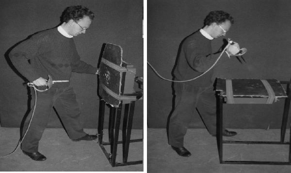

These low energy figures are the work done by the hand pushing on the knife pushing on the target during the stab. The instrumented "weapon" used for such tests is usually very light, and its motion before impact doesn't contribute much (if at all) to the energy of the hit. (The energy of the moving hand and forearm should contribute.)
With a heavy weapon, once it's up to moderate speed, you have a lot of energy before impact. That gets delivered to the target. The usual knife stab energy measurements don't include that.

The knife stab tests by Horsfall et al included fairly elaborate sensors. Their results stand generally consistent with a number of other similar studies. While kinetic energy isn't the only thing that matters, for penetrating armor it's a good measure. As far as the dory numbers from A Storm of Spears go, they appear to be calculated simply from the weight of the weapon (1.4kg) and its velocity (8.1-8.3 m/s). The Horsfall tests suggest that such calculations may underestimate the energy delivered by 50% or more. (The test knife weighed 0.6kg and the highest velocity was 11.6 m/s, which delivered 115 J rather than 40 J.)

As you said, Horsfall's values with 115 joules and overarm grip, and 60 joules with underarm grip were both done with dagger. Anyway, in these tests, maximum speed was just 11.5m/s, which would only produce 40 joules with 0.6kg dagger.. So how exactly could that dagger get to 115 joules?
I think the only explanation is, that it got additional momentum/weight from men and his muscles who was stabbing with it. If we look at men physiology, and which muscles are active with underarm and overarm thrusting, it is quite obvious that overarm relies on in majority on deltoid, but also on pectoralis major and latissimus dorsi. You are also doing much longer movement which activates these muscles better increasing possible momentum.
Anyway, with proper underarm grip, with hand at the height of your chest, pushing forward, you would fully activate pectoralis major in some kind of similar movement like bench-press, which suggest quite a lot more strength than you can deal with your deltoids. Anyway this still doesn't explain why Horsfall got totally different values for underarm and overarm grip. Anyway, when you look at Mathews work, he is actually mentioning 4 possible thrust methods - overarm, underarm, reverse and low underarm. Low (underarm) thrust in his tests got lower speed of 8.1m/s. yet, with low thrust, you only engage muscles of your deltoid, major body muscles play only very minor role in thrust, which means that additional momentum is much lower than with other thrusting attacks.
Also, because Horsfall tests were actually performed with dagger, we can exclude upper underarm thrust as being used, and instead it is most probable low thrust was used which is most natural for dagger thrusts. Which explains the big difference in output energy between overarm and underarm (low) thrust in his test.

As said above, those tests don't measure kinetic energy. The dagger never gets to 115J; the stab delivers 115J.
The test "knife" has a force sensor between blade and hilt. This records the force during the stab. There is also an accelerometer, which measures the deceleration of the knife during the stab. At the end of the stab, the knife is stationary, so the acceleration can be integrated backwards over time to find the velocity of the knife over time. Force times velocity is power (i.e., rate of delivering energy), so this can be integrated over time to find the total delivered energy.

Could just be because it's easier to push harder into the downward stab. You push the knife, the knife pushes back (Newton's 3rd law of motion). With the downward strike, that reaction force has to lift (close to) your body weight before you become unstable. With a forward strike, that reaction force just has to push you backwards.
See attached pic for the weapon and model stabs.
Attachment: 25.71 KB
![horsfall_stabs.jpg](files/horsfall_stabs_823.jpg)
Stabbing actions from I. Horsfall, P.D. Prosser, C.H. Watson, S.M. Champion, An assessment of human performance in stabbing, Forensic Science International 102 (1999) 79–89
