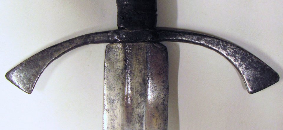

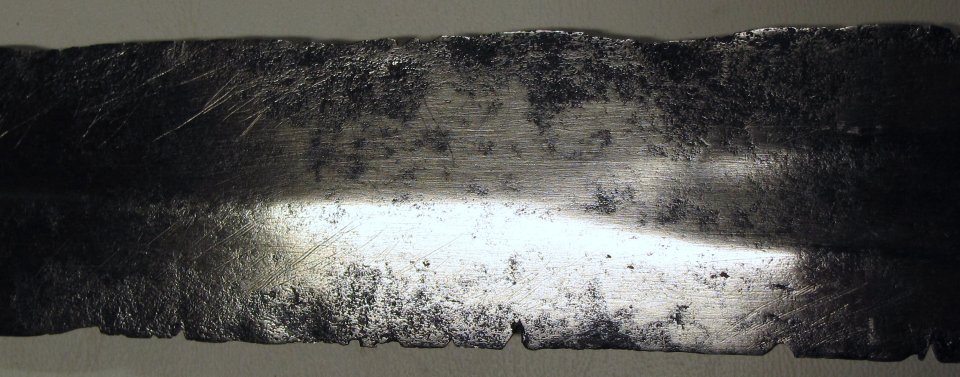

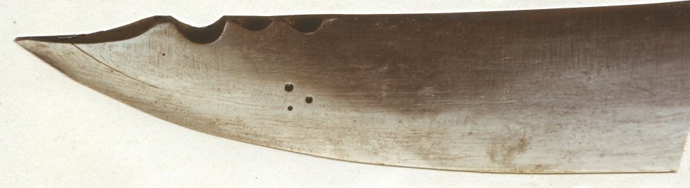

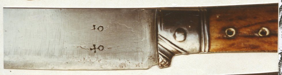

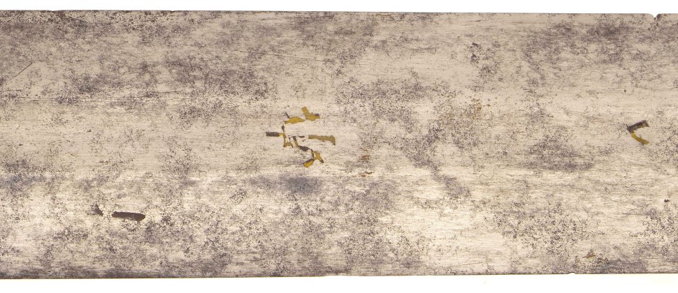

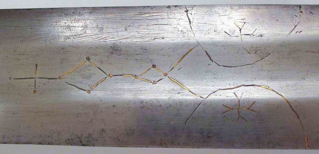

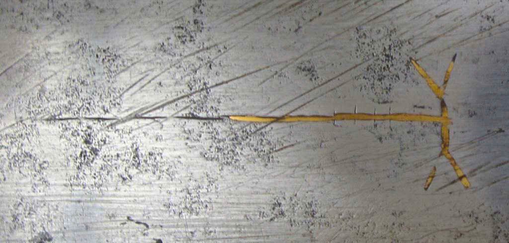

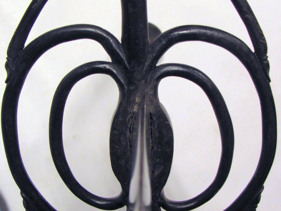

Would you find a finish such as is seen on the following historical pieces acceptable on a replica?
 Attachment: 107.54 KB
 Attachment: 30.85 KB
 Attachment: 83.29 KB
 Attachment: 86.21 KB
 Attachment: 107.18 KB
 Attachment: 65.89 KB
 Attachment: 95.41 KB
 Attachment: 73.38 KB

PostPosted: Sun 23 Dec, 2012 6:58 pm    Post subject:         Reply with quote

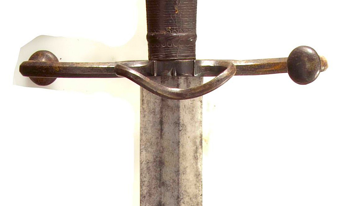

Some more examples. I would especially want to know what people would think of a replica with a pommel attachment like the one below. On a related note, a link to the thread on asymmetry in originals: http://www.myArmoury.com/talk/viewtopic.php?t...=asymmetry
If anyone else has some good pics of the finish on originals or replicas, I would love to see them.
 Attachment: 71.41 KB
 Attachment: 98.71 KB

Depends on the purpose of the piece. Is it supposed to accurately represent the original, including character? If so then the finish is fine. If the reproduction is supposed to be "inspired by" then I'd be inclined to want an improved finish.
PostPosted: Sun 23 Dec, 2012 9:49 pm    Post subject:         Reply with quote
This is a complex question and I suspect you won't find total consensus. I have pieces that have filemarks on them that many people would consider unacceptable. I don't mind them, because I've seen worse on period pieces in museums and in the antiques I've been lucky enough to handle.
I think the answer to the question of why we don't see more of that kind of finish is multi-faceted. In no particular order:
1) Method of manufacture: Modern tools make it easier to get a uniform finish. There is, in some cases (not all by a long shot), less handwork and more machine work in today's pieces.
2) Modern people who collect swords tend to live in neat and tidy parts of the world. Few people today would accept a car with an uneven paint finish or sloppy fit of the doors to the body or a DVD player whose tray doesn't close evenly/fully. This ties into #1: we have tools and processes that make precision more widely available and our world looks more precise. The expectation in most consumer goods is a level of precision.
3) Swords are often (not always) viewed by collectors as something of a luxury item. We pay handsome sums for them in many cases. For some people (not all), a marked-up finish is a sign of sloppy work. In a luxury/prized possession/this-cost-a-lot-for-an-item-that-isn't-a-necessity context, a sword with an even, lovely finish better fits with many people's ideas and expectations, for better or for worse.
4) Many people haven't seen antiques up close or in detailed enough photos. The books that are widely available and widely read because of their cost tend to show items without a ton of up-close detail. Because they often show a four foot sword via a four inch picture, details like surface finish is lost. Many people don't go to museums either so they haven't seen this stuff up close.
5) The idea of craftsmanship may be warped. Often, people think of good craftsmanship as being how close someone can get to perfect in terms of symmetry, fit, and finish. Because you often pay more for a hand-crafted item than a mass-produced one, the expectations go up with the price-tag. A better finish usually takes more work and can enhance the feeling of extra value/luxury. That ties into #3 as well.
What would I accept? Like Joe, it depends. If I'm buying from someone who uses a healthy dose of modern tools and methods, I'd expect a high level of finish because that's attainable, can be attractive in a way, and is easier to maintain in some regards. If the order is with someone working more with period techniques, I'd expect a result closer to that of a historical piece.

Very true, Chad and David. I have seen some pics of swords from the same area and time period with practically perfect, mirror-like or satin finishes. The few 16th C swords I have seen in person varied a good bit in finish, but were somewhere in the middle between these two extremes. I am pretty sure the marks on the swords above are artifacts of the finishing process because blades I have finished with traditional methods (file, stones, abrasive on leather or wood) look exactly like that at a certain point in the process. Probably 3/4 of the process is getting it from this stage to a fine satin finish. Working life dammage is more likely to take the form of nicked, curled or chipped edges, transverse scratches, dents and gouges than almost perfectly parallel scratches running down the blade.
Thank you all for your well thought out replies.

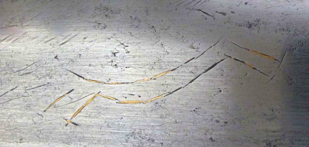

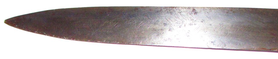

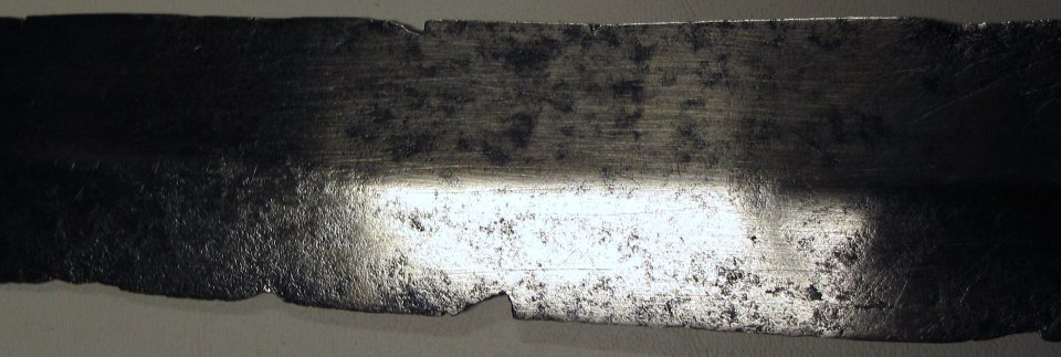

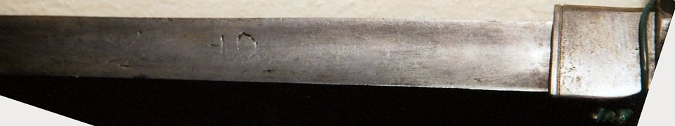

Edit: Here is a more balanced selection of closeups of finish. Some look like they were originally very finely finished. I have heard that 19th C museum personnel sometimes got pretty carried away with polishing, but I doubt that that could account for a very large proportion of these smooth pieces. It would take a lot of grinding to clean up some of the rougher examples above. So while in many cases we will not be able to know exactly what the pieces looked like originally, I think it is safe to say that renaissance cutlers used a wide range of degrees of finishing, probably signicantly wider than we are (in general) willing to tolerate today. Still, if your responses are a good indicator, there are some people, especially those with more experience seeing originals, who could appreciate a less perfect finish on certain swords. Thanks again for your input.
 Attachment: 249.31 KB
 Attachment: 134.71 KB
 Attachment: 60.88 KB
 Attachment: 44.97 KB
 Attachment: 29.67 KB
 Attachment: 42.87 KB

Just to be clear, I am not talking about corrosion or patination. I am talking about actual artifacts of the production proccess that would be seen on a sword fresh from the cutler's shop. I would not consider any of the swords shown to be less than decent quality, quite the opposite, they are all high-quality weapons. I tried to find pics of swords with minimal corrosion, patination and dammage from working life or after to give us as good an idea of possible of how they would have appeared when new.

That bent over peen looks like it is supposed to be the stem on a piece of fruit. Those look like leaves chiseled into the pommel. That's a pretty clever concept, and I like it, but I wouldn't be keen on having one, it looks like it could catch on your palm.
For that to be acceptable I would want to feel it in hand.
If it's on a single hander, that would make sense, and I would like it.

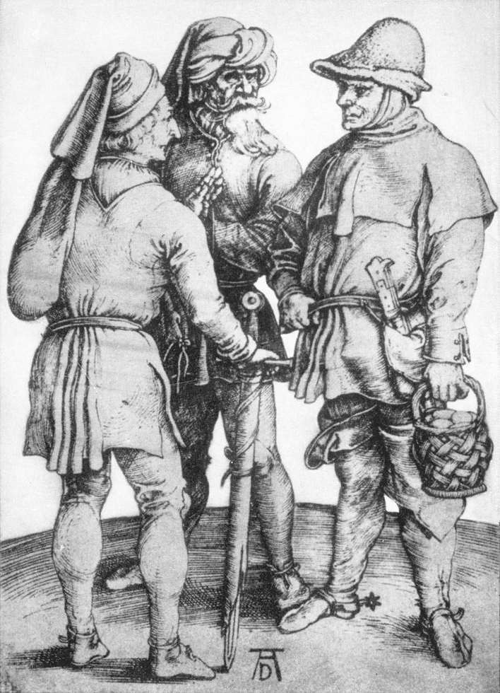

Jack, I would love to see any evidence you may have to support your assertion. It seems that there are far too many weapons with excellent finish for them to have all belonged to royalty and high nobles. I am sure there were some who took a very practical view of their weapons, but just as many must have been every bit as concerned with aesthetics. I think it is safe to say that attitudes toward weapons varied as much then as they do now.
Luka, here is one exception at least (attachment below.) This guy does not appear to have given his sword the best upkeep though Wink
Judging by the swords features, it could easily be a couple hundred years old at this point. I wonder if there are any documents from the later middle ages or renaissance that mention swords being sent out for polishing? Or maybe people spent a lot of time maintaining their swords themselves? I really like the look of well-used and "over-polished" swords, with rounded, softened lines and a more "complex complection" for lack of a better term.
Mathew, I find your observation on that peen quite interesting. So maybe it wasn't a labor-saving shortcut but an intentional decorative feature. I agree that something like that could be pretty cool on a single-hander, maybe one with writhen cross or a German style basket-hilt with a floral or plant theme.
 Attachment: 111.6 KB

I love this picture. Big Grin Great excuse for someone reenacting both 12th and 16th century German to wear the same sword for both kits. Wink But it actually goes along with my point as this peasant wears sword no professional would use if he could afford anything newer. Happy
