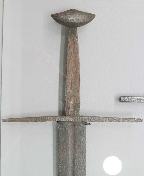

PostPosted: Fri 01 Jun, 2012 11:45 am    Post subject:         Reply with quote
Here's another example, from the Castlerock museum. I don't have specs, but you can see how its grip length compares to the other swords in the case. I could get my hand pretty close to the case and the grip was a couple inches longer than my hand's width.

PostPosted: Fri 01 Jun, 2012 4:39 pm    Post subject:         Reply with quote
That's a very interesting case full of weapons -- thanks Chad!
Could you estimate the dimensions on that big guy? About 6.5" in the grip, and 36"+ in the blade?
PostPosted: Fri 01 Jun, 2012 9:08 pm    Post subject:         Reply with quote
I'd say closer to 6 inches on the grip. Your blade measurement guess could be close.
Kai Lawson
Joined: 26 Aug 2010
Posts: 589
PostPosted: Fri 01 Jun, 2012 9:09 pm    Post subject:         Reply with quote
Hi Joe--
Grip is about 6.5'', maybe 7''; blade is definitely longer than 36'', even broken off. My money would be about 39'' or 40'' with tip intact. Fairly thin in cross section down the whole--probably a rather fast sword

PostPosted: Fri 01 Jun, 2012 9:15 pm    Post subject:         Reply with quote
Kai Lawson wrote:
Hi Joe--
I think that's a bit too long for the grip. I held my hand over the tang pretty close to the case. That hand measures 3.75 inches at its widest. I don't think that there was an extra 3+ inches of tang left over unless you're counting the pommel. I could be wrong, though. Happy It definitely was longer than a single-hander, though.

PostPosted: Sat 02 Jun, 2012 2:36 pm    Post subject:         Reply with quote
Thanks, guys. The middle sword is very intriguing, too; it looks like a XIV in the style of Oakeshott's 'Moonbrand'. Any thoughts on that one, or closer pics?
PostPosted: Sat 02 Jun, 2012 3:18 pm    Post subject:         Reply with quote
It's actually single edged. I have plenty of pics, but you'll need to be patient. I won't post any more pics of the single edged sword in this thread as it's off topic. Happy

PostPosted: Sat 02 Jun, 2012 3:21 pm    Post subject:         Reply with quote
Aside from the "specs" what's the dating and general 'localization' of those? That would be very interesting to know, if someone managed to date them at least roughly.
PostPosted: Sat 02 Jun, 2012 8:56 pm    Post subject:         Reply with quote
I didn't right that down or photograph the info (nor memorize it). Perhaps another visitor to the museum can provide that.
Luka Borscak
Location: Croatia
Joined: 11 Jun 2007
Posts: 2,307
PostPosted: Sun 03 Jun, 2012 6:56 am    Post subject:         Reply with quote
Well, if we take other very similar swords into account, this one should be either late 12th or first half of the 13th century...
