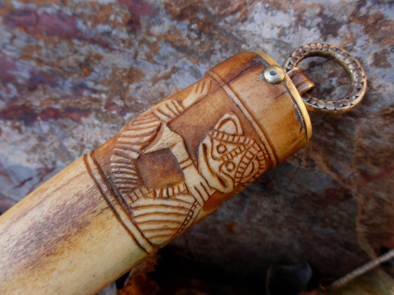

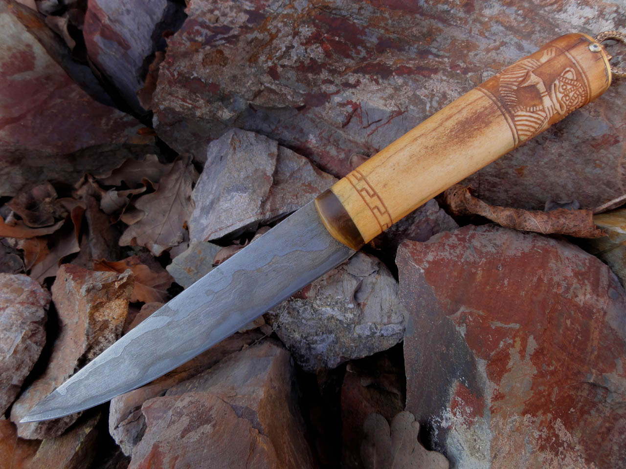

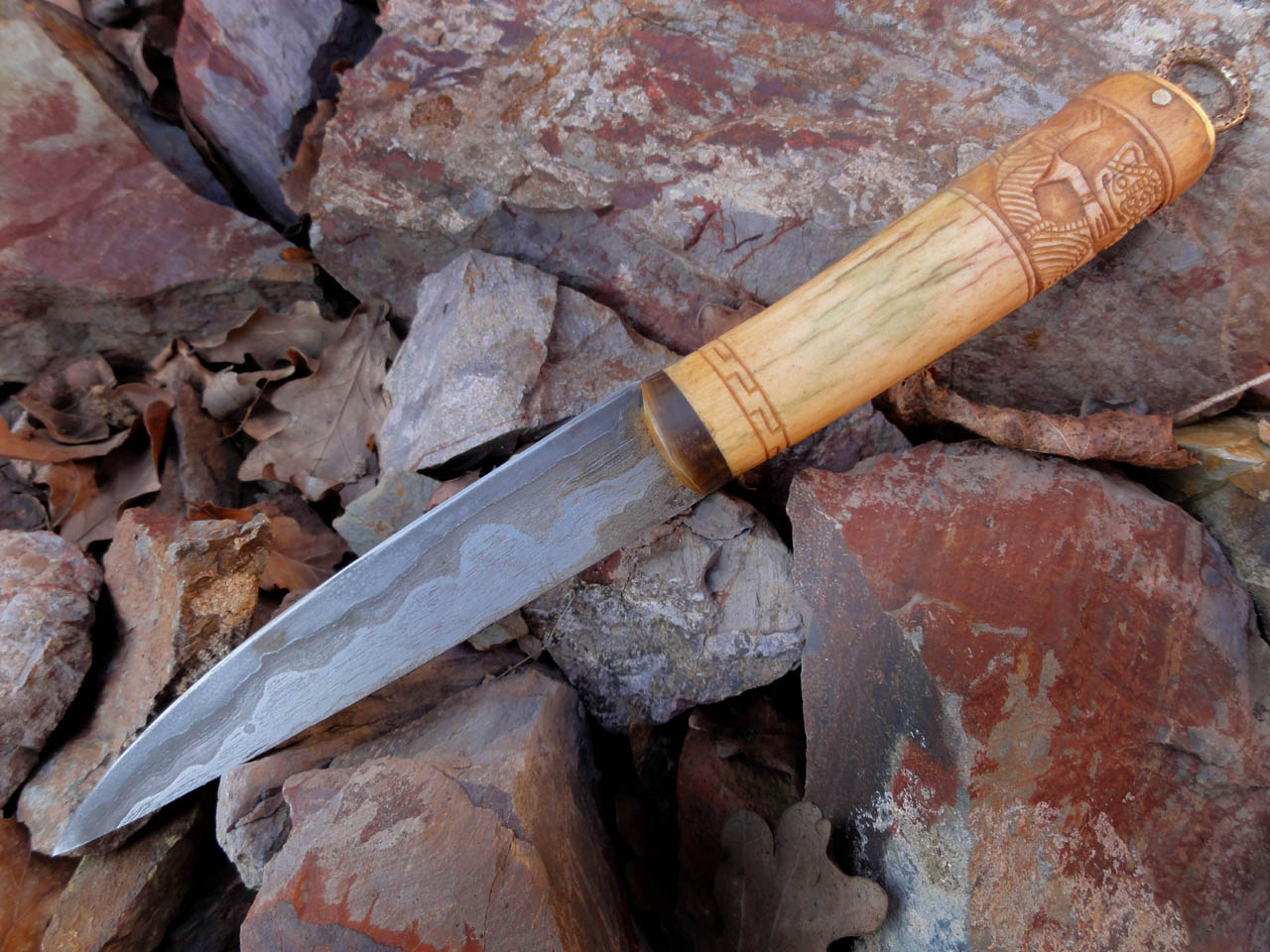

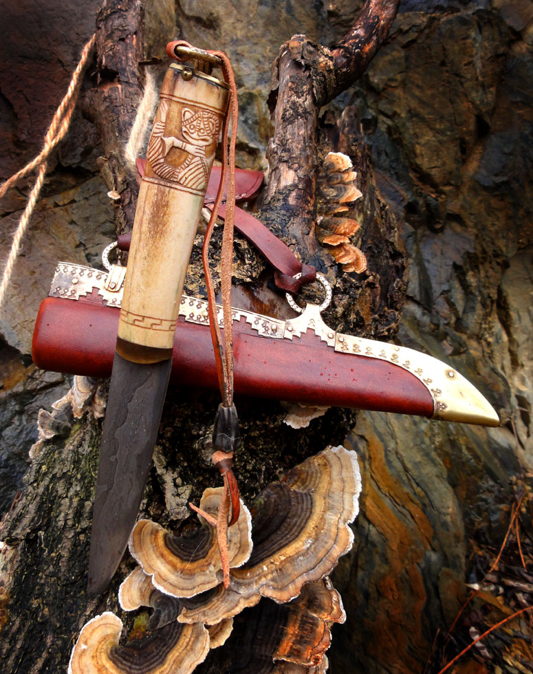

Hello! i just thought i will also share what i have in progress. Its viking womans knife, welded wrought iron and carbon steel in san mai construction, handle is cow horn, moose antler and brass.
Its decorated in early viking style with two gripping beasts (freyas cats?)

Nice work.
What's the rivet/pin for at the top of the handle?

Thanks Matthew, thats the pin holding the band in which the ring is attached.

I love the littl details that are so often missed like the rivet head and the handle ring with the formed 'beads'

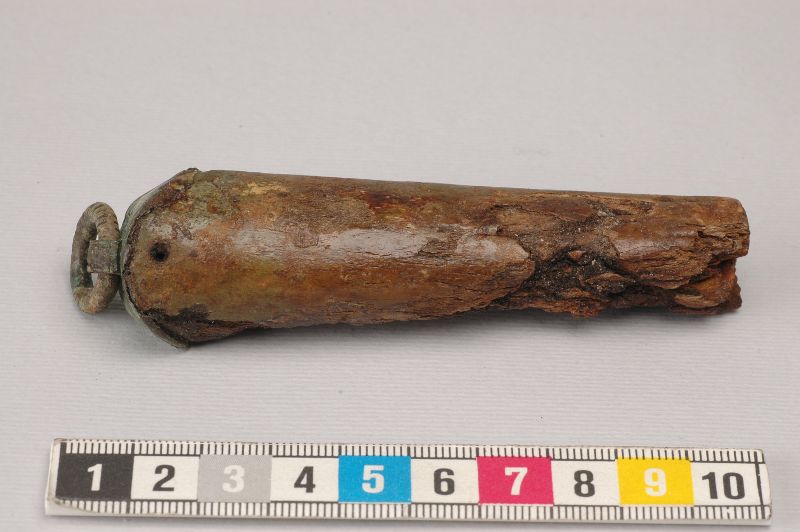

Since there were questions about the pin holding the pull ring, I though it would be a good time to post a photo of a find with one from the same time period.
This one is from viking age, found at a place called Grötinge, Norrvike on the island of Gotland, Sweden. State histrical museum item # 27778
Link to the Kringla.nu site: http://www.kringla.nu/kringla/objekt?text=vik...ect/450127
Only the handle remains of this find but it shows the pull ring, the back plate and the pin going all the way through the handle. I've also seen other finds where it's hidden and the back plate is nailed in place and I'm making one of those myself right now.

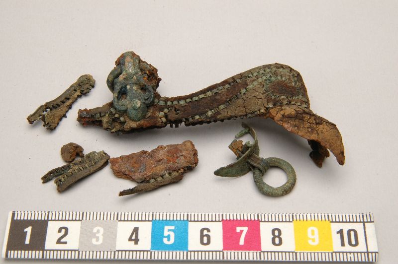

Here's another pull ring assembly for those who're interested. Very neat design really.

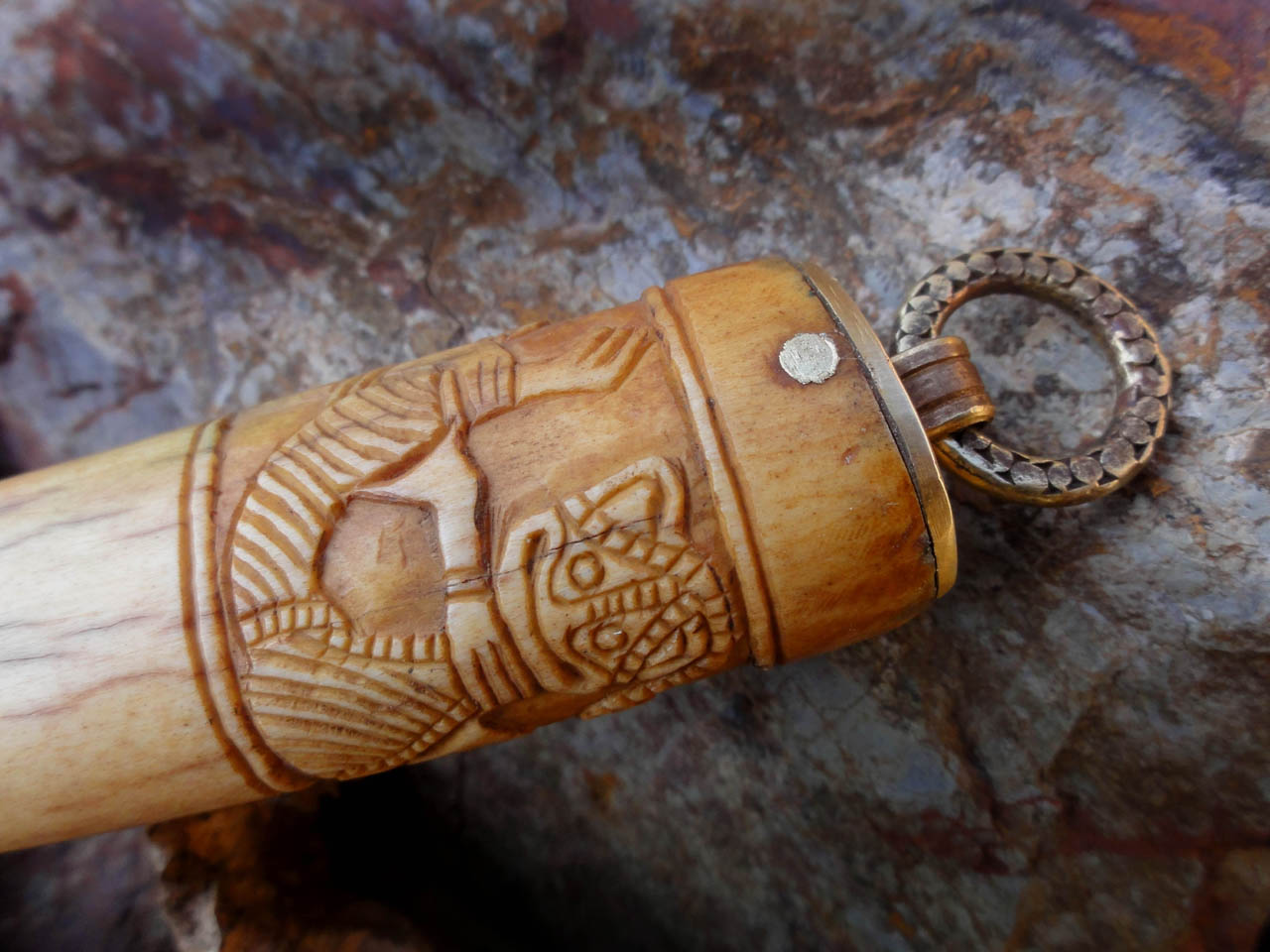

Thanks Johan!
I made this curved cap variety too

Oh that's beautiful Petr.
Thanks for those pics Johan. I've not seen that style of end cap fitting before. What's the time-frame for this style and is it restricted to Gotland?

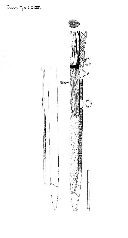

Just says "Viking age" on the data sheets for most of the finds.
Most with an intact pull ring are indeed from Gotland, at least the finds with photos in the database. But other finds don't make sense without one. Like some of the large knives from Uppland/ Vendel (the area Vendel, not "vendel age") that go all the way into the sceath leather with nothing to grab to pull it out unless the hole at the center of the back plate is for some form of pull ring fastener.
Like this one:
Also, a back plate with a peened tang through it doesn't need the extra nails. But if the hole is for a pull function and doesn't have a peen there it does.

Hello! Here is the finished knife with sheath, I hope you like it.
if you want similar knife, or sax, drop me a line, i love to make those

Beautiful work Petr.
