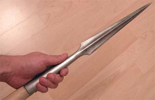

It occurs to me that one of my old (and sold) spear projects could be adapted. That was a Hanwei Viking Throwing Spear with all of the decoration ground off. The Hanwei head is still on the market for about $40 and no longer has the fake aging of the blade. The socket could be cut down a bit and the blade shape refined to make something not at all bad for a leading staff. The langets would have to be separate or welded, of course. But it could make a serviceable piece.
 Attachment: 43.43 KB
