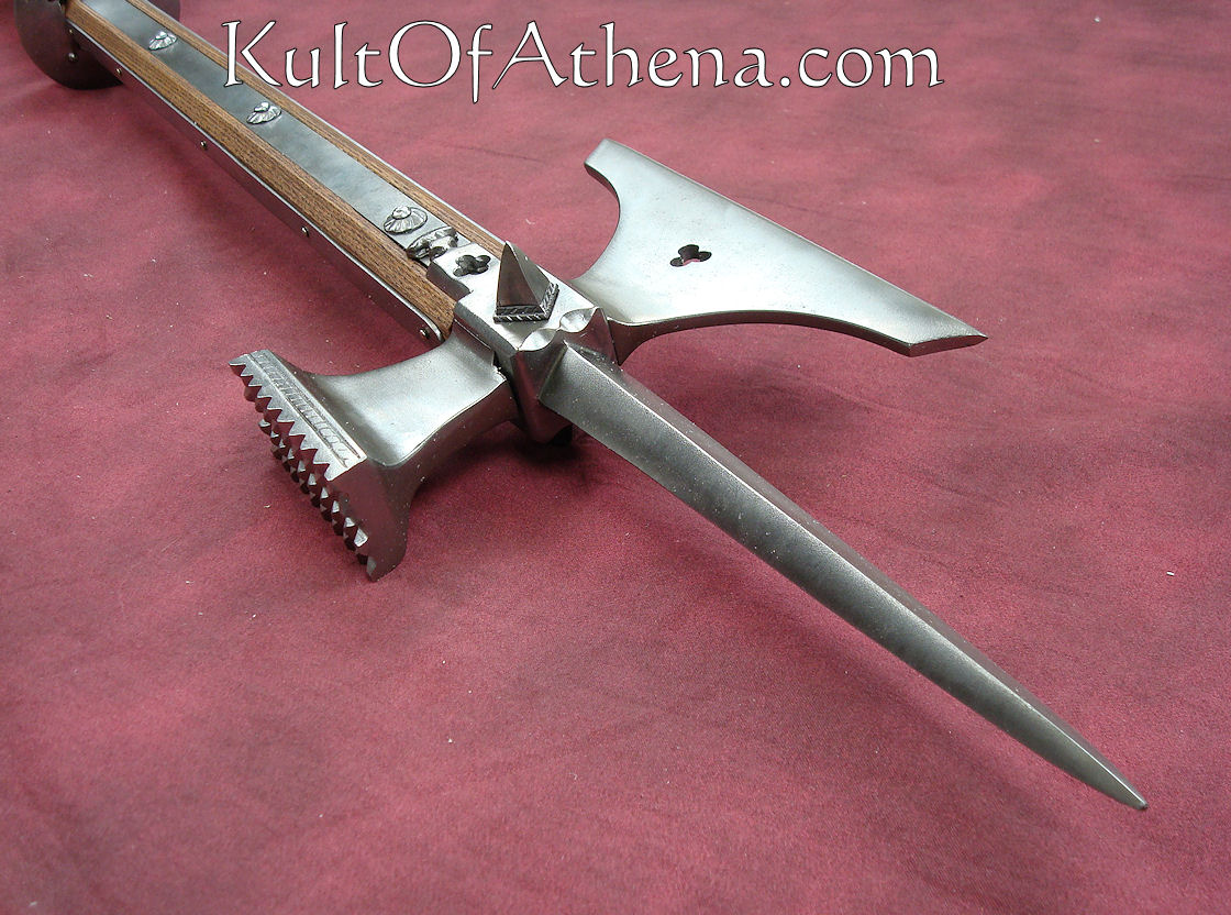

Is there a step-by-step video showing how a poleaxe head is made? I am referring to poleaxes like the two famous ones at the Wallace Collection.
Having made a war hammer from a pall-pien hammer, I can only guess at the assembly. The hammer part is placed over the end of the haft. Then metal wedges are "nailed" into the end to secure the hammer in place. The top spike/langets part is then placed over the hammer and riveted into position.
However, how are the components made? How do you make a hammer head with one side being an axe blade and the other side is blunt with a "waffle iron" pattern? How is the top spike attached to the langets? I can see, based on my thinking, how the langets begin as a narrow rectangular piece of metal. This piece gets bent in two places to form an inverted "U" with very long legs. The two bends form the center square section where the top spike gets attached. But how?
Or ... does the top spike/langets part somehow begin as one piece that is made into the top spike and langets. Is one end of a block of steel split to form two langets, and the other end is hammered into a top spike?
I suspect a blacksmtih began with two rectangular blocks of metal. One becomes the hammer part and the other becomes the top spike/langets part.
I humbly request somebody post a video of this process on youtube if you know how to do it. I am simply curious. I am not try to become anyone's competitor in the replica market. This is simply a question I am tired of dealing with. Please give me relief.

Speculation, while sometimes fun, doesn't help us. We need to discuss facts. Medieval and renaissance poleaxes such as the one the original poster is asking about were not cast.
FWIW, I know of only one such visual explanation, and it's for a Tudor bill. It's in a detailed chapter of Weapons of Warre: The Armaments of the Mary Rose (vol II). In fact, I can't think of anything quite like it for any weapon type. Waldman's polearm book has x-rays and illuminating discussion of manufacture for halberds but not much about poleaxes of the type that interests you. The short answer is that they were forged, forge-welded, ground, filed and polished using the same techniques used for other polearm forms and weapons. They just tend to be finely-finished high-status weapons. You can see typical construction in A&A's wonderful example.

I tried to explain the construction of poleaxes in several articles I wrote - one yet to be published (though I have less and less hope for that as years pass by) based on my lecture a the 2nd I.A.A.C. in Vienna in 2005...
But I also give hints to this in the description of a poleaxe I made and posted here a while ago :
http://www.myArmoury.com/talk/viewtopic.php?t...ht=poleaxe
..and making this one took 5 different pieces of metal (two for the head, trhree for the spike block) - not couting the side lugs (or side bands on the haft).
Poleaxe making was a complicated process. Lots of welding, fitting, filing. High level of skill implied at every step.
They were not the crude weapons one might think of - not speaking of this forum's users of course ;).

In addition to what Fab said, it's probably worth also mentioning that there were different ways of putting pollaxes together. The two examples in the Wallace Collection differ quite a lot, one of them being put together somewhat like Talhoffer's 1459 drawings:
