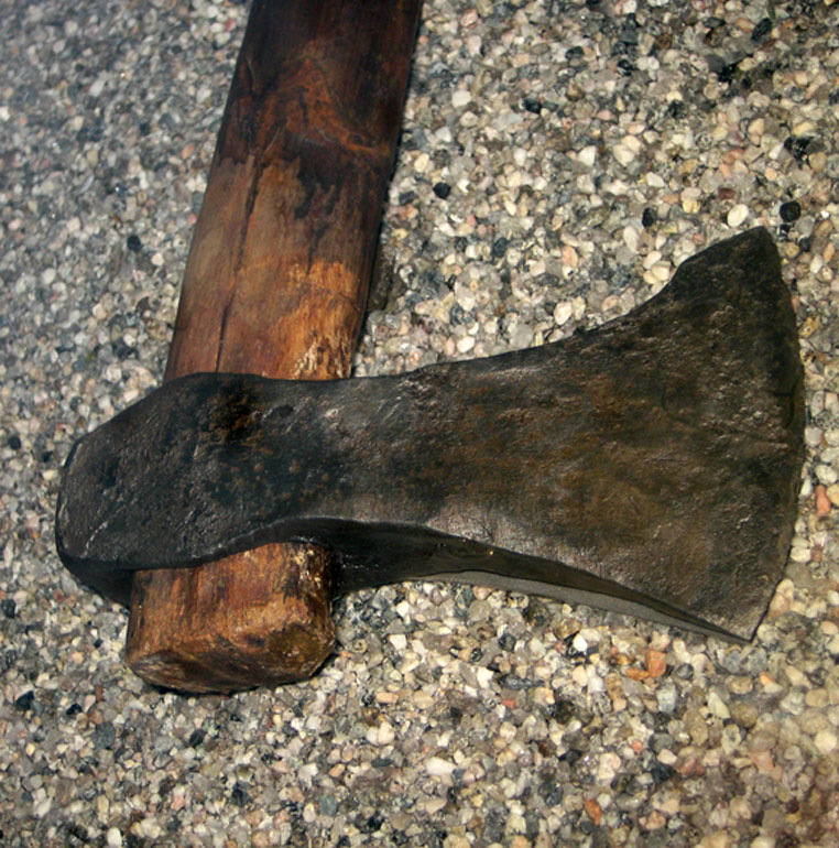

Here's that axe from the top. Johan, I tried emailing you a huge file of it but emails are getting bounced back today for some reason.

So that axe has a darker section of the top a face. A round plug wedge perhaps? What do you guys think?
There is definitely a different colour of wood in the center, quite possibly a circular wedge. However, this raises the question why? To use such a wedge they would have had to drill a fairly large hole, while they had the capability to do this it would seem like more work than cutting a slot and using a normal wedge. Another thing I notice is that there are no cracks around the edge indicating that the wedge has not expanded the wood very much unless there is a crack on the front or back that I cannot see.

"So that axe has a darker section of the top a face. A round plug wedge perhaps? What do you guys think?"
Well, this is a shot in the dark type of guess but do you think the darker section could be heartwood?

If you are speaking about the last photo then this axe sure seems to have a normal wedge.Crack in the handle supports this idea. And you can see a line that goes across the middle of the shaft end. The darker area in the center looks somewhat strange and could be caused for example by hammer hitting the wood when driving in the wedge. If the wedge was plug-type then the shaft would have had more cracks, considering how much it extends from the axe head.

I have seen viking age axe with small steel wedges still preserved. Not trace of the wooden haft, but there were wedged inserted from the top to expand the exposed end of the haft.
It is impossible to know if this was the way it was always done, but it is proof that the axe head was sometimes slipped on the top end of the haft and wedges used to expand the wood to pinch the eye from the inside.
Hafts may have been slipped on from the grip end all the way, like a tomahawk, or one of those Nydam axes. That is also a viable method. I have seen no proof of this having been used in the viking period. It may have, but the only method I have seen traces of are the preserved iron wedges. Wood wedges may of course also have been used, but will rot together with the haft.
