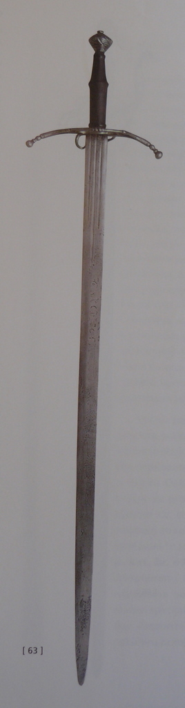

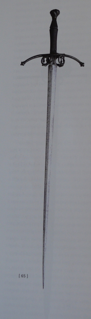

Hey everybody-
By now many people know I'm interested in compound-hilted swords. Over the last few years I've had a particular interest in 16th century compound-hilted longswords.
I'm looking for examples of a particular type. It looks to be a symmetric type with downward sloping quillons, two side rings, finger rings, and loops connecting the finger rings to the side rings. A decorative motif of knobs/balls divide up the bars and act as finials and are often adorned with a twisted motif.
Thank you for any help you may provide.
I'll include some examples here:
Here is another example though I don't believe this one is necessarily original to the 16th century:
And you can see an example here just below the 9 o'clock position:

Here's one that appears to have all the same makers marks as the first one posted, no further information other than ca.1600.
Michael.

Flickin' through old files I came across a few more, The one in the group shot from a 'Fricker Historische Waffen' catalouge, the other from 'Fischer Auctions Sept. 2007', catalouge in German so all I could make out was ca.1520, 1315mm.
As with people, I too am quite partial to complex bastards.
Cheers.
