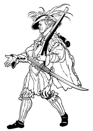

This appears to be the same general type and period, so it's a clue to length, scabbard and suspension (looks like there's a by-knife as well).
What is the timeframe of the image? Late 15th or early to mid 16th?
