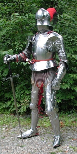

Christian Henry Tobler
Location: Oxford, CT
Joined: 25 Aug 2003
Posts: 704
PostPosted: Sun 22 Aug, 2004 8:36 am    Post subject:         Reply with quote
Steve Fabert wrote:
Some of the plate sabatons were clearly intended for use on horseback only. The longer the toe, the less practical it was to try to walk in them, let alone fight. I have a pair of plate sabatons whose toes are only about three inches longer than my foot, but even at this length it's hard to avoid tripping. Some were much longer than this.
Hi Steve,
You really shouldn't be having this problem with three inch pointed sabatons. Are you wearing a similarly shaped shoe beneath them? Otherwise, there's nothing holding the toe up and the tendency will be for it to slope slightly down, which makes it likely to foul up on grass or soil.
Here's a pic of mine:
Christian
PS. Jeff - thanks for posting your armour pics. That's an outstanding harness.
Joined: 25 Aug 2003
Posts: 704
PostPosted: Sun 22 Aug, 2004 11:26 am    Post subject:         Reply with quote
Hi again Steve,
Yes, these are custom fitted. I had to make a cast of my entire leg so that the sabaton, and the high cut leg harnesses, all fit properly. The harness was done by Christian Flecther, just in time to appear in my first book, Secrets of German Medieval Swordsmanship. Here's the whole harness, from a recent picture:
Take care,
Christian

Adam R
Location: Vale of Belvoir, UK
Joined: 15 Jan 2004
Posts: 39
PostPosted: Mon 23 Aug, 2004 4:24 am    Post subject:         Reply with quote
Hi Russ and Jeff, hi-jack away, my question was answered well enough already.
Hey Christian, those besagews, do they impede your arm movement at all, like your range in halfsword for example?
Adam Roylance
KDF Nottingham
www.nottinghamsword.co.uk
Joined: 25 Aug 2003
Posts: 704
PostPosted: Mon 23 Aug, 2004 6:51 am    Post subject:         Reply with quote
Hi Adam,
No, aside from hearing them, I'm not even aware of their presence. They float out of the way quite easily.
