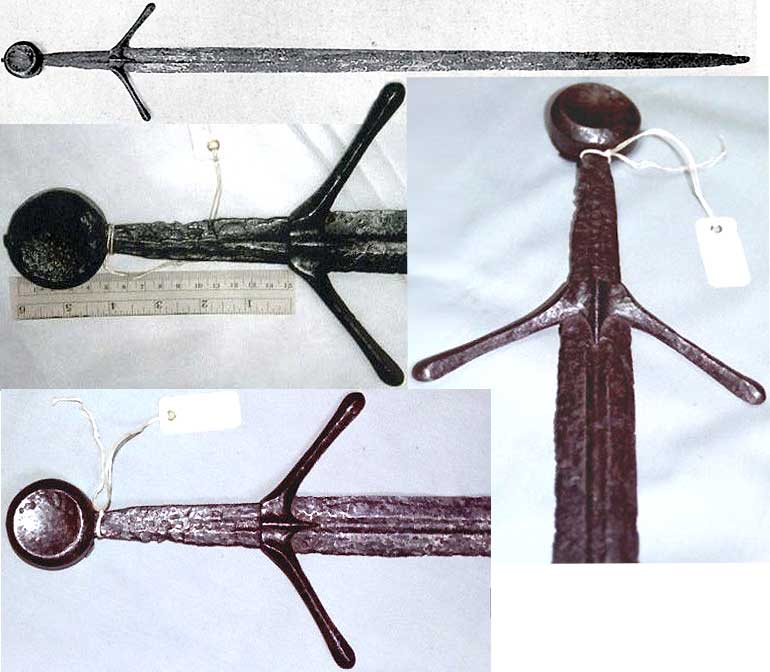

J.D. Crawford wrote:
That's very interesting - it looks like a novel design - was there any particular inspiration for this?
I wish there were more quality Scottish medieval swords on the market. I tried to commission one but it did not seem to work out. Recently I gave in and bought Albion's Caithness (Also very nice, although I'm not generally a CNC fan).
Good luck with this product line.
The general idea came from this style of sword. At no point were we trying to make that sword, but the general shape appealed to me. Went with another scottish pommel instead of the hollowed wheel. I had this sword in mind while making the parts for my piece, but I actually didnt find a picture untill I was done. So I am certainly going to go back and do another one that is closer to the original piece.

Matthew Stagmer wrote:
The general idea came from this style of sword. At no point were we trying to make that sword, but the general shape appealed to me. Went with another scottish pommel instead of the hollowed wheel. I had this sword in mind while making the parts for my piece, but I actually didnt find a picture untill I was done. So I am certainly going to go back and do another one that is closer to the original piece.]
That's a famous and beautiful sword! A more faithful reproduction of this historical piece would be one to watch for. Del Tin has something along these lines, but if memory serves right, the pommel is convex and the fuller is much longer.
While I agree with you and more lately I have leaned towards historical reproductions, I still find a lot of pleasure in taking historical shapes and concepts and applying them to my own design.
I promise to show a historical example of this piece soon. Now that I have good pictures to work from.
just FYI that sword cross on the original contains a hollow socket, its not solid..... like many scottish swords hilts in that 15th and early 16th c. i like your sword! nice work. tr
