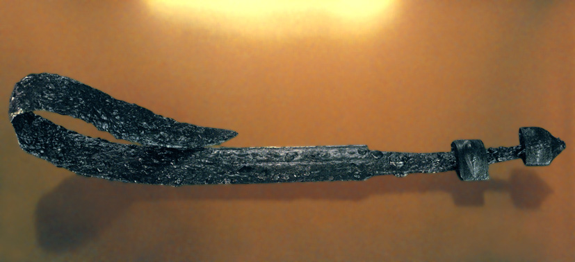

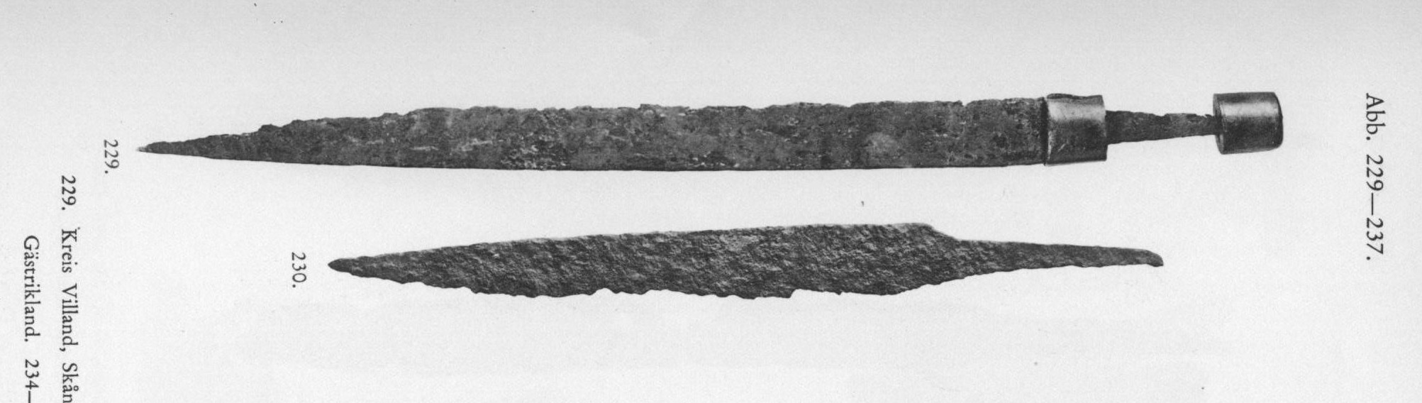

Looking great! Yeah, the grips are a bit of a guess, as no we so far haven't come across any examples with preserved organic hilts. However, there's two Scandinavian single edged swords with metal hilt parts. The first one from Finland I presume is the one you used as an example. The second one is from Sweden.
Attachment: 84.73 KB
Attachment: 185.06 KB
