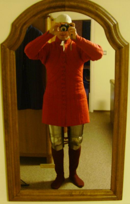

The gambeson samples they show in the hand stitched section seem to be made by Kokosz from Poland. At least he is pictured in a few other pictures on that page. I had him make me a padded helmet liner and aventail. He does use raw wool to fill the tubes and it is too stiff. Even when using wool it should be fluffy still.
I had those guys make me an Aketon http://www.medieval-market.biz/goods.php?kate...at2=Arming Garments
You can give them a lot details and they incorporate everything. In my opinion the Aketon of the later 14th cent should be as tight as possible without restricting moement and breathing.
Mine is differential thickness in different parts of the garment and I just send it back for modifying the lower arms having them even more tight and less padding.
This is the old picture, but it is already tight in the body and upper arms

Nice picture Happy It seems to fit really snug around your waist, but I can't really tell. You could be a really skinny guy Happy How snug is it? Is there any room between your body and the gambeson or does it really fit like a second skin? I'm wondering about parts like the arc of your back for example.
The gambeson I tried left just a little room between my back and the back of the gambeson when I stood straight. I could pull it tighter a bit so the front flaps overlapped by about 10 centimeters at the waist line. I am wondering if that is too roomy or if a tighter fit would hamper movement too much.

Mine is quite good fitting at the torso and hip section. At first it was as wide as in the situation you described. I brought it back to the medieval market guys, they modified it and sent it back to me. Then it was the tight fit it is now in the picture. Maybe it could be a faint tighter, but it must not be. The tight fit around hips and shoullders is really good, so the garment doesn´t moove muh with the armour attached.
In my opinion, you won´t be able to order a garment that is 100% perfect in the first place. So you need a maker that will help you modify it after trying it on and after some time of using it. So you can see what needs to be modified. Better would be to have the maker take your measurments, in case they really know how to do it and even then they have to be able to make a proper garment out of it.
In conclusion, I can recommend the people of medieval market because of a ok fit in the first place and really good customer service with the modification.

Dan Howard wrote:
Keep in mind that if you want period-correct armour then you also need assistants to help you put it on. Historically, if you couldn't afford a servant or two then you definitely couldn't afford a suit of mail.
True, but since I live in the 21st century I'll have to do without squires who do my every bidding. Also, it's not the hauberk I have trouble getting off (I don't own one yet, but I did try on a few). It's the snug gambeson without an opening Happy
Maurizio D'Angelo wrote:
What you buy, is linen .
This is already good in order to use between the different periods.
I think the rest are a bit different than the twelfth century than the fifteenth century ...
The Matuls gameson I saw is linnen, so I am good there. I know that the model changed over the centuries but I hope I can get away with it. It may not be good enough for serious and very period-specific living history events, but I hope it will look good enough so that I can participate as a squire or generic man-at-arms in reenactment. It won't be perfect, but I won't look too out of place (I hope).
There are not a lot of reenactment events in The Netherlands and they all focus on different time periods. I hope that with a generic backup kit of a gambeson + a kettle hat I will be able to join many of them as a simple man-at-arms. It's better than only being able to go to one or two events every year Happy
Dan Howard
Joined: 08 Dec 2004
Posts: 3,658
PostPosted: Mon 29 Mar, 2010 4:02 am    Post subject:         Reply with quote
Regarding putting armour on by yourself: This is another difference between coats of plates and brigandines. The coat of plates fastened at the rear which meant that it couldn't be put on without assistance. Brigandines were fastened at the sides or front so you can put it on yourself. This could imply that brigandines were worn by a greater number of people (reaching much lower in the ranks) than the COP.
Sander Marechal
Location: The Netherlands
Joined: 04 Dec 2009
Reading list: 17 books
Posts: 671
PostPosted: Mon 29 Mar, 2010 6:05 am    Post subject:         Reply with quote
Perhaps. Most references to the CoP I see are the Wisby coats. IIRC these were from 1361 and already quite outdated by that time. Most references I read about brigandines put them at the very late 14th century at the earliest, well after the Wisby-style coat of plates if you incorporate that outdatedness.
Personally I am starting to think that corrazinas, cuirasses and brigandines (all of which open to the front or sides) were all used earlier than generally accepted but that we simply don't know about it because everyone was still wearing surcoats and other things to cover them up. If you look at the effigy analysis on body defences then you can see that from the 1350's up there was some kind of rounded but covered up body defence.
Certainly as lower and lower ranks started to wear more armour during the 14th century, the ability to get into and out of your armour by yourself became more important. Including front-opening gambesons Happy
Reinier van Noort
Joined: 13 Dec 2006
Posts: 165
PostPosted: Mon 29 Mar, 2010 6:15 am    Post subject:         Reply with quote
Then why is the Maciejowski bible full of normal soldiers with gambesons that are not front-opening?
