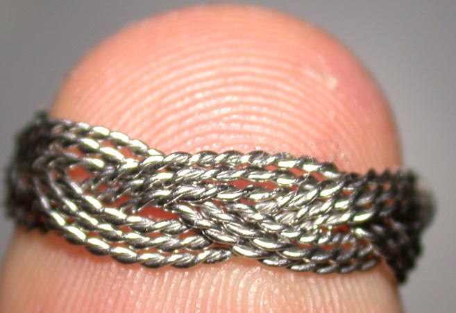

Thanks for the tips, folks! I recently tried the three-wire braid with mixed success as you can see below. These faux THs looked a-historically thin to me so I scapped them. If I were to do it again I think I'd separate nine strands from the multi-strand picture hanging wire I used, braid those in three-strand bundles, then braid the resulting three braids into a final, single braid. That would make for a more robust and complex faux TH. I'd still like to learn to do this properly with twisted wire, but I suppose my best bet is to simply experiment using the rope diagrams as a guide.

I agree with Mr. Erickson, that it is really much easier if you can see it done but it is possible to learn how from a rope guide like the one you found online Sean. The reason I say this is because that is how I learned, my teacher knew how to tie them but didn't like doing it so he gave me some pointers and a photocopy of a how to guide and I went to work. If you start with a thicker rope it might be easier because the stiffness will help the first two wraps hold their position while you are doing the weaving with the third wrap. once you have the first set of wraps completed it is just a matter of tracing them with the remaining rope till they are all equal. I usually do three times around per wrap (total of nine times around) but you can do more, it just becomes more cumbersome and harder to judge the finished size of the turks head and amount of material needed from the start.
I would recommend that you keep tying a rope turks head till you know how to do it by heart because when you start trying to size one correctly for a grip there are other things that you need to pay attention to. It is kind of frustrating but I just sat down with the TV on and kept trying to tie them with the guide, till I figured it out. I have found that for wire turk's heads for grips if you have 4'-6' of wire to start with that should be enough, but this will be determined by the diameter of your grip so that is just a loose estimate. I always try to have a little extra just for safety, it really sucks when you are in your last wrap and you run out of wire 3/4 of the way through.
Now once you get it down with rope, do the same thing with wire. I found that two 28ga wires twisted together gives you a good amount of resistance but not too much and looks nice as a finished piece. If you try to tie a turks head with heavy wire it is really a bear, especially if you are working with stainless so this might be more frustrating than it is worth. Silver or copper, bronze or really thin wire also have their drawbacks because they are so soft that they kink like mad as you are threading them through. If you want to work with really soft wire I suggest buying some good wire working pliers for jewelry applications which will help you smooth out the kinks. I have found that working with 2 twisted 28ga stainless steel or even annealed steel wires is a good medium to learn with because they play along better than thinner or thicker wire.
I usually bend little waves in the wire that outline the shape of the weave as I am starting the first 2 wraps, and then set them when I intertwine the 3rd wrap with the first 2, do your best to make sure that the bends are all the same distance from the centerline because if you have more material in one bend it will make the turks head lopsided in that spot. I use a ring mandrel, a soft mallet, an awl (to push the wire around and straighten out kinks), a pear of needle nose pliers (for grasping and pulling the wire), and of course a small wire cutter to cut the excess off when done. I often use a taylors measuring tape or some string to measure the circumference of the finished grip I am tying the turks head for then compare that to the sizing scale on the ring mandrel for reference. I then start my wraps slightly smaller in circumference than where the circumference of the grip came out to be. The reason for starting smaller is that when I have the turks head completely tied I then gently stretch it with the soft mallet on the ring mandrel till it reaches a just slightly larger circumference than the grip. The reality of a wire turk's head is that you can stretch it but not shrink it when it is finished. In addition this does a few things, it tightens up the weave as well as smoothes out the wire a little bit. You want the finished turks head to fit on the grip so that it will stay in place with a friction fit if possible, otherwise it will spin and move considerably on the grip. If it is a tad loose you can sometimes fix that with glue of some kind, but it is usually better to just tie another turkss head knot. I found that as long as the truk's head knot you have tied is in the right ballpark size you can shape a future grip to fit that turks head. Of course you can start this way, by tying a turks head then making a grip to fit it, but for me it usually works better to shape the grip so that it looks right and then make the truks head to fit that shape.
Hope this is of some help to you, good luck with your efforts.
Erik

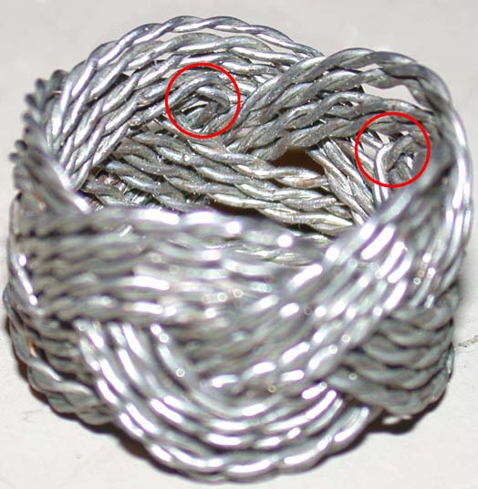

Thanks for the very informative post. Could you show us another photo of the side of the turks head where the ends come together? I'm curious as to how the ends are joined so that everything looks smooth and even.

Here is a photo of the inside of a different turks head, this is one of my practice ones. Because of the lighting and the close focus the wire ends are hard to see. The red circles show where the bent wire ends are. the tension of the weave holds everything together, I just kink the ends of the wire so they won't pull out of the weave but will hook on the other wire if they are pulled. If you try to twist the ends together or anything like that you get an ugly bulge in the turks head when it is compressed around the grip. In the rope demo they usually show a fishermens knot or something similar crossing over the back of the wires securing the ends together, but with wire this is unnecessary and very hard to make look good.
Erik

Thanks Erik, that clears it up considerably for me.

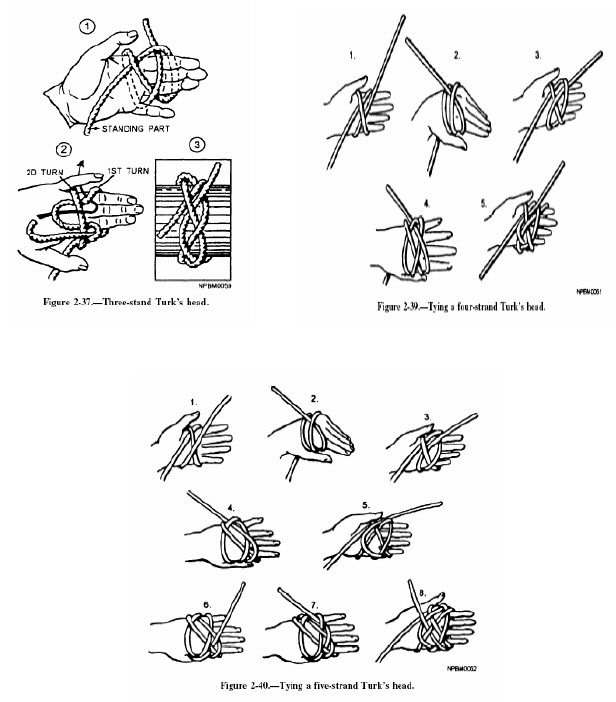

Here's a page from the BM's training manual. But it's a little bit light on the words (it is for BMs after all).
 Attachment: 58.18 KB
Pax,
Sam Barris

By the way, I think the knot diagram Sam posted is for a more complex TH knot. The book I have offers two TH knots, and describes "our" knot as the more primitive of the two.
