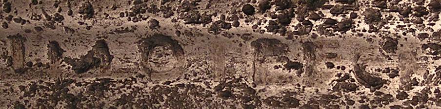

Yes, let us not forget the apprentices, and feel sorry for the ones whose letters shifted as the smith’s hammer descended – although, chances are it was the apprentice with the hammer and the smith managing placement, that is more the natural order in the smithy.
I am going to propose that the letters must have been done as a group, in one or a few heats, and not individually or in small groups, just to stir up the cauldron of ideas & hopefully foster further experimentation. If Mikko and I are the only ones trying the techniques out, it may take us a while to sift through the options to find the most likely answers….
The letters were done as a group for following reasons:
-Smiths in general like to maximize work done per heat, and placing letters by ones and twos while the sword is hot wastes several letters worth of heat to either side of the placed letter(s).
-Heating high carbon steel is risky to the material, so bladesmiths would be minimizing the heats as well, especially late in the process.
-Labor was cheap, charcoal and steel expensive, so the labor of cold inlaying the sig so it could be welded in one heat is probably more than balanced out by the fuel saved.
-One would expect the artifacts with inscriptions to be strongly showing uneven amounts of inlay preserved within a single inscription, if the letters were installed in individual operations, but most of the inlays seem to be either there or gone – though if one follows up a lower-temp setting operation with a welding heat to secure everything that would take care of that issue.
These are just my impressions, of course, I don’t have much to back them up, in terms of archaeo-sociology… it just seems like the wrong kind of inefficiency to me. It also seems that the old inscriptions seem a little too tidy to have been done that way, though well-trained apprentices would certainly make the job easier...
I really like the idea of using higher-carbon material for the inlay. It would make for an easier welding operation too, since high carbon is stickier at lower temperatures, and it would explain those swords where the inlay is more corroded than the surrounding blade. I know one Ulfberht was analyzed and found to have an iron (“nearly carbon free” or “Inläggningarna är nästan helt kolfria” in Swedish) inlay, but I have not seen any reports on the later swords’ inlay material. There’s a nice photo of the metal deformation under the inlay in that Fornvännen article.

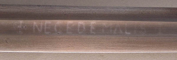

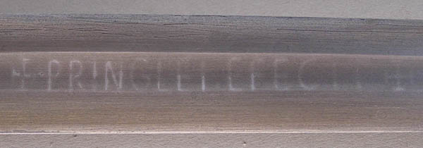

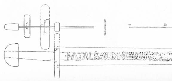

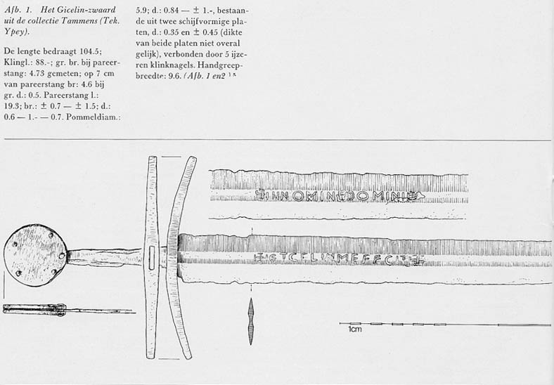

Pattern-welded swords with inlaid inscriptions are mentioned in a couple reports, Lech Marek in “Early Medieval Swords from Central and Eastern Europe” reproduces a drawing of one from Polcyn, and Ypey’s drawing of Atalbaldii’s sword is attached…that is a sword with a six-bar pattern-welded core and Ulf-style sig. Also, a Gicelin drawing of Ypey’s and photos of an inlay I did last year via the “cold inlay then weld” method.
Look, an internet post with bibliography!
Ypey, J
Vroeg-middeleeuvse wapens uit Nederlandse verzamelingen
ROB 12/13 (1962/63)
Een Gicelin-zwaard in Nederland.
Antiek 6; pp. 521-527 1972.
Polcyn M. 1991, Znaleziska roślinne w podwodnej warstwie kulturowej w obrębie reliktów wczesnośredniowiecznego mostu poznańskiego w jeziorze Lednica, [w:] Wstęp do paleoekologii Lednickiego Parku Krajobrazowego, Poznań.
Törnblom, M
Metallografisk analys av inläggningar i vikingatida svärdsklinga,
inv. nr SHM 907 Go, Hogrän sn, Ålands
Fornvännen 76 1981

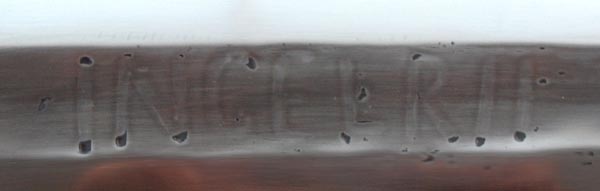

Indeed, the inlays can be seen without etching on the surface of a polished blade. In the attachment is an INGELRII blade I did few years ago as a part of my experiments. This blade was not etched, and still the inlays can be seen very clearly on the polished blade.
I have also thought about that theory of yours, Jeff. Maybe the inlays could have been arranged on a hot iron bar with welded flux on it, perhaps quartz sand. I think that flux is the only alternative, since the bar with letters have to be placed on a hot blade blank. I can't think of other "glue" that would hold. I guess this alternative needs testing...
The multiple pieces of inlays could indicate cold inlay, of course. I have managed to inlay for example letters E, F and M from multiple pieces without cold inlaying. The height of these letters was ca. 1 cm. Since the inlaid rods were so small in diameter, they had to be hammered quickly, and so one letter could be hammered with one heat. Of course the accuracy is not the same as doing cold inlay, but the technique is plausible. In connection with original blades, microscopic analyses are needed to find out more about the techniques. It is strange that scholars seem to be interested in what is inlaid, instead (and additionally) how it is inlayed. I personally believe that Iron Age blacksmiths have done it in multiple ways.
