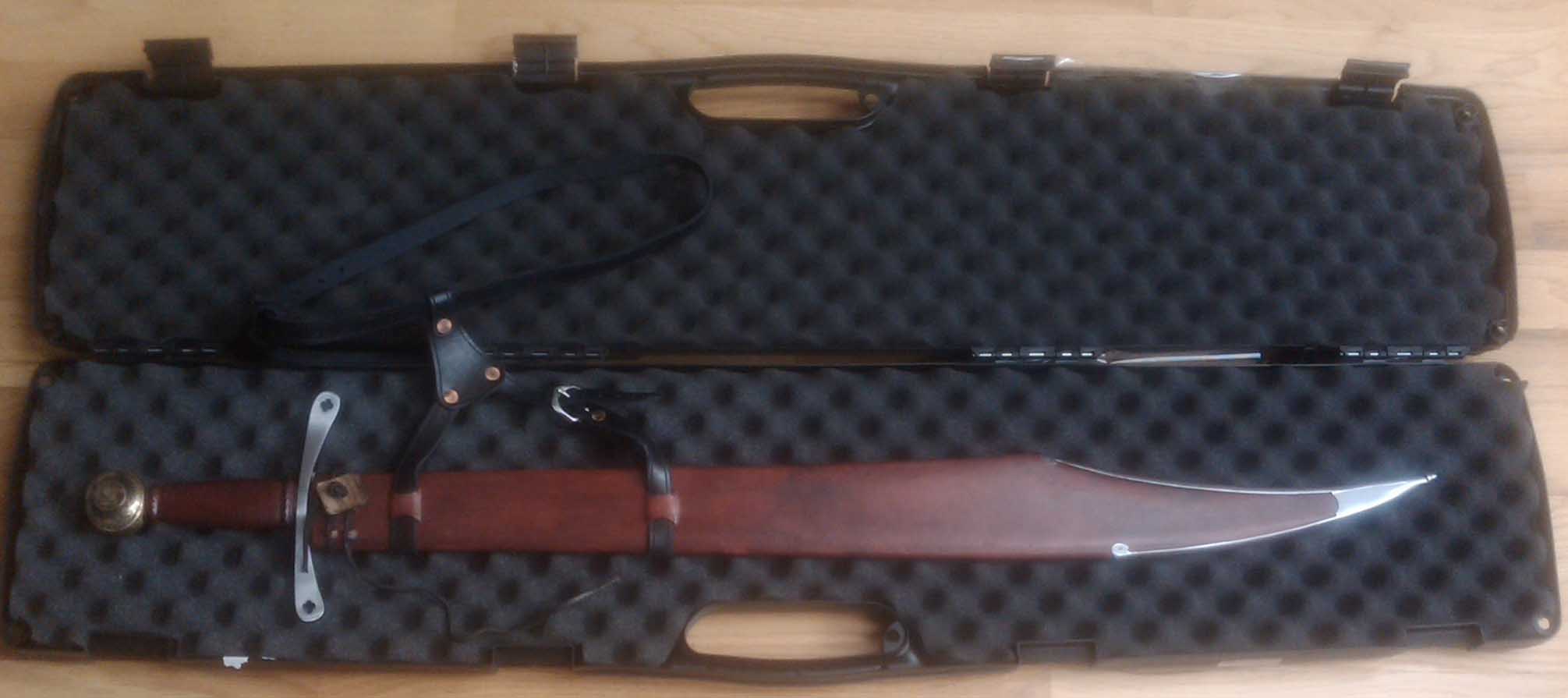

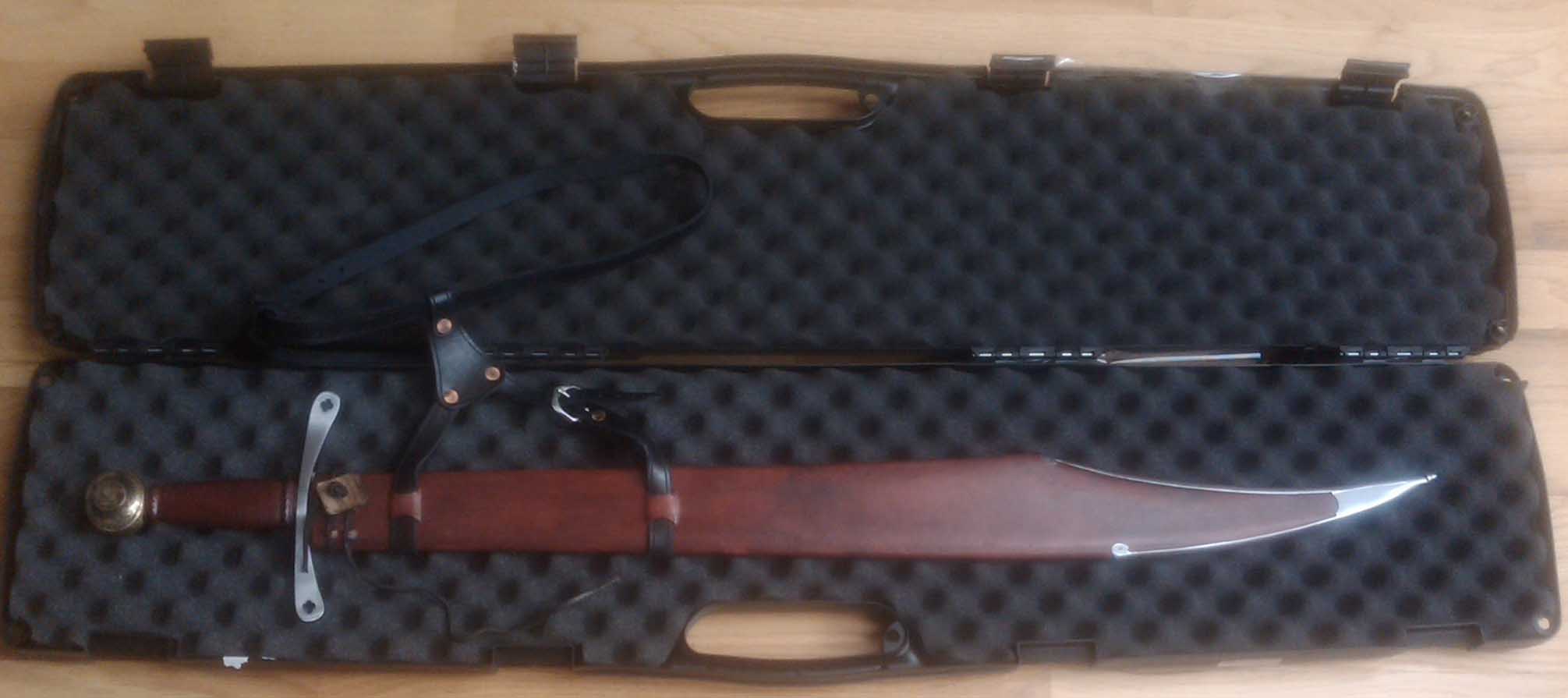

PostPosted: Sun 22 Mar, 2009 10:37 pm    Post subject:         Reply with quote
I still haven't heard from Alan West... he never responded to a couple emails.
In any case, SEE ATTACHMENTS for pictures of the final product in hand:
 Attachment: 134.55 KB
 Attachment: 115.57 KB
 Attachment: 83.79 KB
