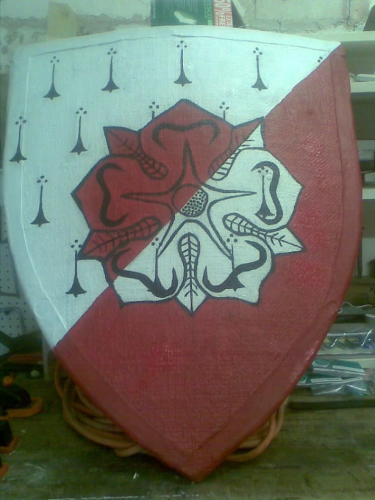

PostPosted: Fri 14 Sep, 2012 8:41 am    Post subject: Home made shield         Reply with quote
Here a shield I made using two boards of plywood following ye olde gaffers suggestions - although we used sash clamps to hold the curve - its 28" across as opposed to 21" but its for a crossbowman to sling around the shoulders rather than to be used just with arming sword (though it can be) the only issue we had was finding the right glue to hold the curve, 2nd time lucky.
 Attachment: 98.25 KB
Shield [ Download ]
