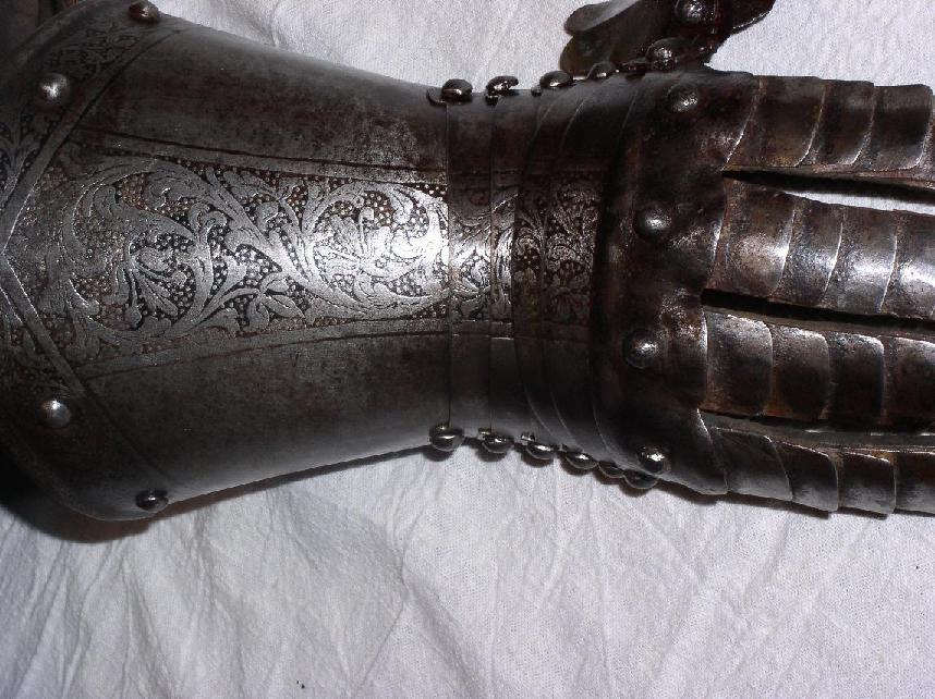

We just got in a couple of new period pieces. The first pictures show fingered gauntlets circa 1560-70 and the other photos are of a gothic cuisse (right leg) circa 1490. Additional Cuisse shots in second email
 Attachment: 117.27 KB
inside gauntlet
 Attachment: 89.69 KB
both gauntlets [ Download ]
 Attachment: 109.29 KB
etching on gauntlet [ Download ]

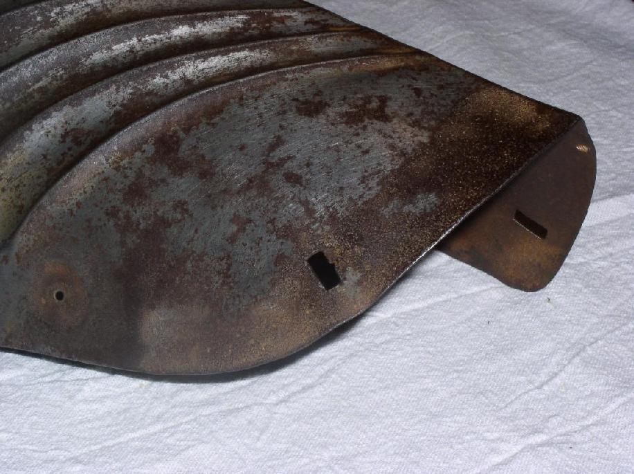

cuisse [ Download ]

Here are the rest of the cuisse pictures
 Attachment: 88.72 KB
inside of the cuisse [ Download ]

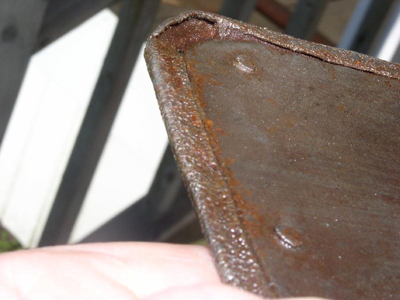

rolled edge with wire [ Download ]
 Attachment: 104.32 KB

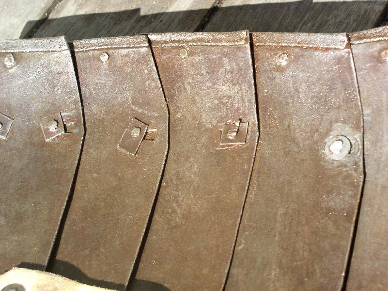

slotting [ Download ]

David, the finger leathers are exceedingly brittle! We're as surprised as you are at the condition. They were "Professionally
Cleaned" before we got them but an application of BreakFree got several lames that were rust locked to free up . The rivets at the cuff that would have held the glove in place have been replaced at some time probably for display purposes
as they do not exhibit the same rust pitting as the rivets in the rest of the construction. For as dry as the leather is for the fingers several of them still exhibit latteral movement ( they swing from side to side at the point where they're attached to the knuckles ) .
Bill, the strength imparted by the ridge geometry is amazing ! You can squeeze the sides in a full two inches each (you're now exerting about maximum force ) and it returns to shape every time ( sacrilege I know, but we've been doing this since we got it ) and its made from 24 gauge steel, tops ! The strength imparted by the geometry of the ridging is truly impressive !

Great pix! Thanks for sharing them. I'm surprised that the cuisse is 24 ga, but I guess we're conditioned to expect thicker metal (14-18g) due to the reproduction/re-enactment market. I really like the repousse (?) on the gauntlet cuffs.

Brian because of the different use armour is put to today ( much heavier, fight practice every Tuesday night and a weekend long event every other weekend... that sort of thing ) modern armour is built in thicker gauges than period work . I was very
suprised at how thin the construct of period peices was myself years back when I first went to The Tower Armouries and
got to look at it close up . The gauntlets are etched in a floral spray pattern with a bird ( an eagle I think ) at the apex of each cuff . Glad you dug the pics . Oh this is Allan. Jason was logged on and happened to see your post so I just started typing .
Jason Perfetto

Oh Brian repousse is basically the same thing as embossing . Small chisels and punches are used to raise shapes on the outside surface of metal by working from the inside surface . Etching is of course using an acid to remove metal in
specific areas to leave a pattern .

Bridal gauntlets AAHHHHLLLLL....( Homer Simpson drooling noise ) . Gordon I so want to make those .
Brian , black and white armours are created by either leaving the plates black from the forge and polishing the recessed
borders and any raised repoussed points or by painting the armour black ( the painted examples i've seen used a very
thick almost stove pipe type oil paint ) and polishing the "white " areas . The darkened color of the etch on the gauntlets
is the area that was slightly eaten away by the acid used so that the design stands out in relief vs etching the design into the metal . This style of etch was very popular and quite common on 16th century armour .

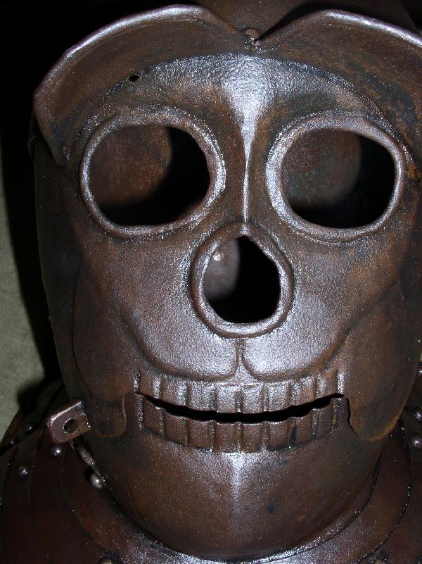

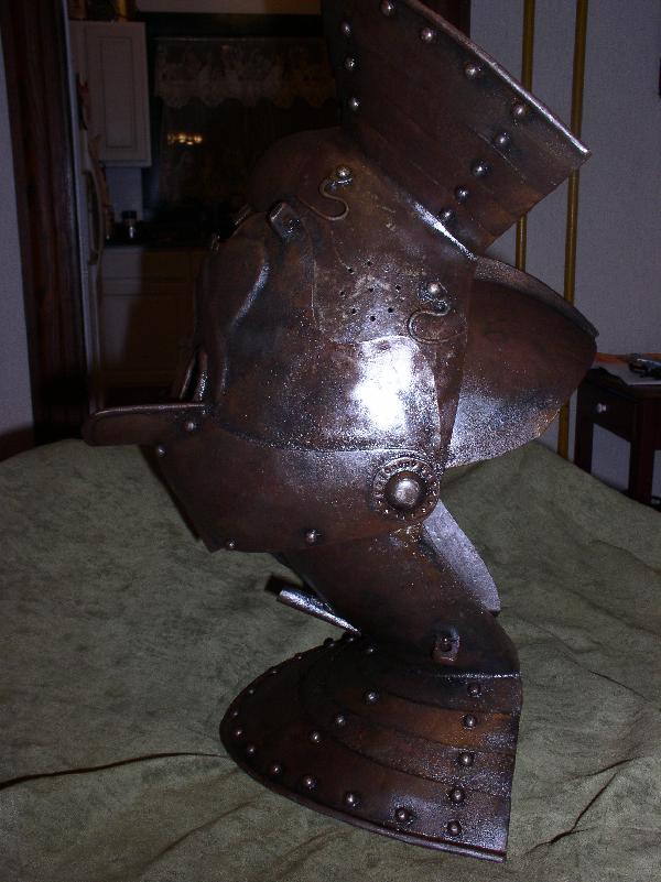

Jason and his credit card aquired this totenkopf helm recently . The seller wasn't sure of its origins ( Victorian or original ) . This is a highly stylized form of this helmet type with the skull motif reposed (sp) into the face of which we've only seen one other ( lost out in an auction last year ) . Based on the construction ( skull forged from one piece , ear holes ect.) it would appear to be from the early to mid17th century but because of two construction details. We think its a funery
piece . It has no liner ( and never had one, no rivet holes at all ) and the neck lames which normally would have been articulated on rivets and leathers are fix riveted so that they don't move . This is the coolest thing we've seen in a long time and it was a struggle not to shut down production to learn how to do it . Enjoy !
 Attachment: 122.88 KB
inside view of helmet - note lames on base
 Attachment: 77.54 KB
Mislocated rivet hole above left eye - typical of period pieces [ Download ]
 Attachment: 100.27 KB
close-up of skull [ Download ]
 Attachment: 83.67 KB
front view with visor open [ Download ]
 Attachment: 69.2 KB
Helmet fully open [ Download ]
