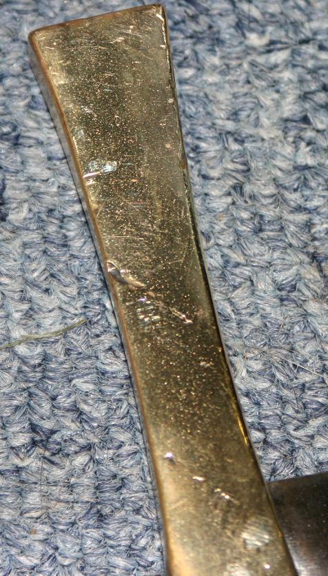

PostPosted: Sat 22 Nov, 2008 8:11 am    Post subject:         Reply with quote
This is the guard from my sword. According the smith who made it its solid brass. Like I said the dents are minor. I like the look of brass furniture on a sword especially when its well polished, it looks great. as for strength if its properly prepared brass can be as hard as mild steel. I have never liked threaded tangs and screw on pommels, the threads create a weak point in the tang and I've seen them snap on the battlefield. In my opinion its more likely poor manufacturing methods and cheap materials than the fact that its brass that is the cause of the defects.
 Attachment: 103.05 KB
 Attachment: 110.85 KB
