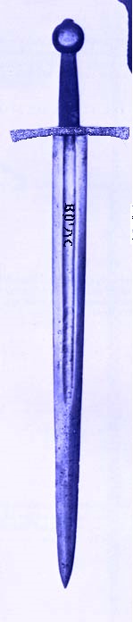

I'd love to find an example of a 14th century sword with a blued blade documented as the original/intentional color.
According to the author's reply, Sir Baldwin's riding sword would look like this;
with this cross;
In addition to the engraved Templar Cross on one side, the letters BOAC were engraved on the other.
BOAC = Beati Omnipotensque Angeli Christi- Blessed and omnipotent the angels of Christ which, as it relates to the character Sir Baldwin, refers to his past life as a Templar Knight (Poor Fellow-Soldiers of Christ and of the Temple of Solomon) but I also noticed that the Latin phrase appears as the title of an article by Oakeshott in a 1986 London Park Lane Arms Fair catalogue. Does anyone know what the Oakeshott reference is?

Here is a bigger picture of the Type XVI riding sword, once in Oakeshott's collection. It went from there to the collection of Douglas Ash, then to the collection of Howard Curtis. This pic is from the Christie's catalogue from the sale of the Curtis collection following his death. I don't know where the sword is now.

PostPosted: Wed 20 Aug, 2008 3:15 pm    Post subject:         Reply with quote
Hmm...so the sword was supposed to look something like this?
Dan
 Attachment: 17.15 KB
PostPosted: Wed 20 Aug, 2008 6:40 pm    Post subject:         Reply with quote
Dan
I doubt it was that neon. Happy I suspect (though I have no idea) that the blue was much deeper.
Dan Dickinson
Location: Michigan
Joined: 03 Oct 2004
Posts: 967
PostPosted: Wed 20 Aug, 2008 7:09 pm    Post subject:         Reply with quote
LoL...yes that's a little neon...but I guess the actual color of peacock blue is up for debate....trying to match it to the actual color of a peacock feather I get this. Of course, the color would be a little more even over the surface.
Dan
 Attachment: 17.14 KB
