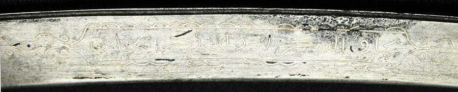

I was talking to some friends about a yataghan I saw and we we curious as to its authenticity. I know there probably isn't a way to know for sure, but I have some pictures and was curious if anyone could offer opinions. Thanks.

It definitely looks hand-made. The blade has too much texture for modern steel, I think, and the decorative details are far too fine and crisp for the kind of cheap souvenier tourists bring from Asia by the shipload. The weathering seems consistent (but not strictly uniform) throughout, so it's either a genuinely old piece, or somebody did a really good job ageing it artificially. The edge doesn't seem to show any appreciable dents or nicks, so either it hasn't been used much, or has been carefully maintained; it's possible it was made as a keepsake or fashion accouterment rather than a serious tool or weapon.
Some context would help and judging from photos is always difficult, but if I had to guess, I'd tentatively suggest 19th or early 20th Century Balkan or thereabouts.

This Yataghan would seem entirely authentic to me. The Islamic date 1199 that appears in your first picture would equate to 1785 in the Christian calendar making this a nice older piece. It is really nice to have the scabbard as well as a lot of times this is missing. I think this is from the Balkan area and the script on the blade old Turkish, the script should probably tell you who made the sword and for whom. Nice sword.

That is a span of over 100 years. With all due respect, it's like dating a Rembrandt painting to 17th or early 18th centuries. I would be very curious to see pictorial references to the early 20th century Balkan yataghans.

Ah, sorry - I meant to type "late 19th to early 20th Century". Little more than a guess, really.
The Oriental Arms site has a fair few Balkanese yataghan. The hilt design on this one seems fairly typical of the regional style. If it really is as old as 1785, I must say it seems very well preserved, a nice find indeed.
