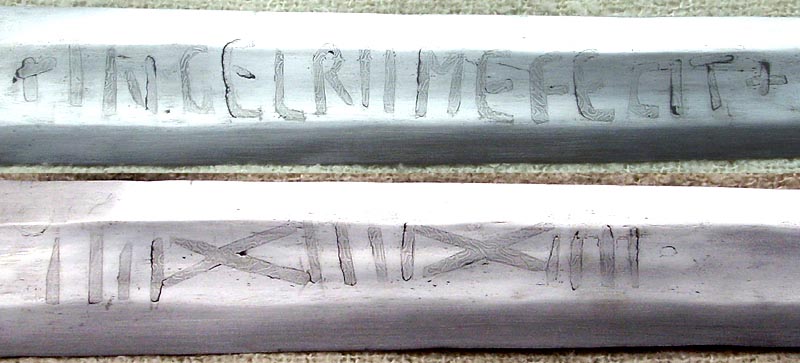

I am a post-graduate student of archaeology in Finland, and I have been writing my doctoral thesis on Viking Age swords, namely those with iron or pattern-welded inlays. I am hoping to finish my thesis within three or four years, after I have studied the material from Finland and, hopefully, from neighbouring countries.
My hypothesis is that various inscriptions and inlays were produced locally and not only in the Frankish realm. The number of inscribed swords is great in Scandinavia, perhaps hundreds. No one has actually examined all of them to find inlays or pattern-welding, which is practically an impossible task for one person, since there are already over 2500 Viking Age blades from Norway, and few hundreds from Sweden and Finland. Furthermore, the materials and outlook of inlays vary a lot, which also leads to suspect that some inlays are from different makers.
My main approach is experimental. Until 2006 I had forged seven blades with either ULFBERHT or INGELRII signatures, all with a little different technique to attach the inlays, and in a different phase of manufacture of the blade. These seven blades formed the basis of my master's thesis. After that I forged four more blades to finish the series of experiments. Since I had some training in blacksmithing from my uncle when I was still in school, I did all the forging experiments myself. By forging experiments I am trying to show that iron inlays could have been done in different ways and so by different makers in different parts of Iron Age Europe.
As a result I had different techniques with which to attach the inlays on the blade. The variations in the techniques occur mainly in the way the inlays are sunk into the blade, and in the phase of manufacture of the blade. Only a ready, polished and sharpened blade could not be inlaid.

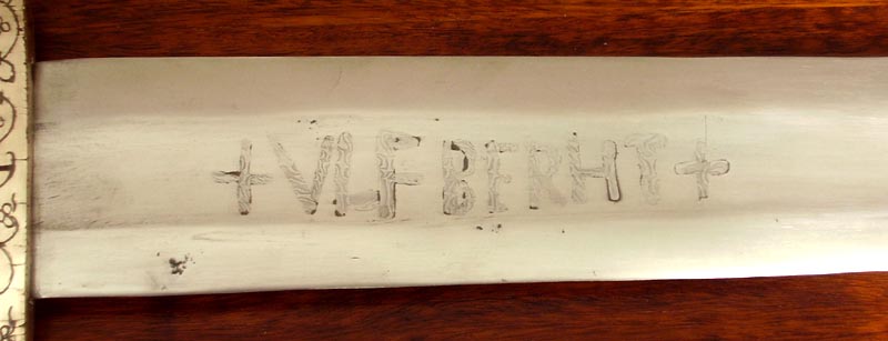

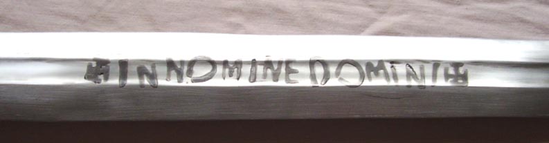

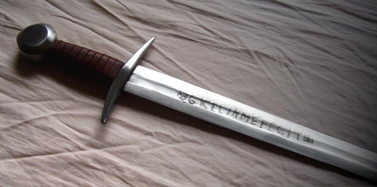

I noticed this thread a few months ago, and finally I have time to show some pictures of my experiments. I am planning a short publication on the experiments, but for the sake of curiosity and comments, I will show some pictures here too.
The first picture shows a reconstruction of the famous Ballinderry sword (Petersen type K) with its ULFBERHT inscription. The second picture is the same blade, this time photographed against a light to enhance the patterns on the inlays. The text ULFBERHT is on one side of the blade, while the lattice is on the opposite side. The inlays have been welded straight on the surface of the blade, having its fuller half-forged. Some of the inlays on the lattice side are missing due to their low depth.
The third picture shows both sides of the blade created in the latest experiment. The blade is made from 18th-century steel, quite close to that used in the Late Iron Age. The inlays were hammered cold in the hot blade blank, after which they were welded with few heats. The depth of the inlays is circa 1.5 millimetres, which is very close to archaeological finds. Only the first inlaid marks on the text side were not properly executed. I did not know that the primitive material of the blade was so soft, and so I did not realize that the inlays could be pounded all the way into the blade. Also, the flaws in the inlays are similar to some examined Finnish finds.
The outlook of the blades is a result of light etching. The materials in the blade in the third picture are contrasted by higher differences in carbon contents.

To begin with, there are numerous disc-pommeled swords in Finland dating to the so-called Crusade period in Finnish chronology, i.e. circa 1050-1150 AD. Some of these swords are most likely a bit later. Many of these types of swords bear iron inlays, most often incomprehensible series of letters, perhaps illiterate versions of INNOMINEDOMINI or something else. As I am currently x-raying Finnish swords, these kinds of small inlays appear continually, and so their amount in the Finnish material cannot be accurately stated. By now there are around twenty swords bearing small iron/steel inlays, some of which are uncertain due to the very bad preservation of the finds.
What is noteworthy, is the material of the inlays. A common assumption is that the inlays are iron while the blade or its surface is steel. In Finnish material this is true in some rare cases. Most often though the inlays appear darker than the blade when etched with Nital or some other mild acid. Moreover, the inlays seem to be corroded more than the blade. Both these observations indicate that either the material of the inlays has a greater carbon content than the blade (or the surface of the fuller to be more precise), or there is some other element present in the blade material, which prevents corrosion. In any case accurate analyses are needed.
In my personal opinion the steel inlays make more sense than iron inlays. When etched the steel inlays appear darker against the polished blade. If blade with iron inlays is etched, the inlays will appear lighter while the surface of the blade etches darker and deeper. In this case the bottom (or the surface) of the fuller is hard to re-polish after the etch, because the inlays will also be polished and the contrast is then destroyed. Of course the welding seams around the edges of the inlaid letters will become more visible due to etching.
A note should also be made about these small inlays executed with pattern-welded material. So far two of these are found in Finnish material, both unpublished since the materials of the inlays have not been considered noteworthy. The patterns in the inlays are VERY fine, but can be observed with bare eyes.
I have once tried to make a sword with GICELINMEFECIT on one side, and INNOMINEDOMINI on the other. The material of the blade was modern carbon steel with a carbon content of 0.5 %, while the inlays were almost pure iron. I welded the inlays straight on the surface of the blade blank, just like I have experimented with ULFBERHTs. The problem was that the inlays did not get deep enough – just as with ULFBERHTs too. Since the inlays were also smaller in scale, they were more easily ground off while finishing the fuller. Also the problem of etching struck me while finishing the blade.
Just as with bigger inlays, the smaller ones should also be sunk deeper in the blade. This in turn can be achieved with multiple ways. One way is to carve the grooves for the letters. This is functional, although very laborious. Alternatively, the grooves could be struck with different punches. This I have done once to create an ULFBERHT-inscription, quite successfully. This also corresponds to archaeological finds, since the structure of the blade is sharply bent underneath the inlays, rather than cut. Still it should be mentioned that inlays of three blades have been analysed, so alternative techniques must have been in use… And none of these analysed inlays were the smaller ones, but big pattern-welded inlays.
Recently I had a commission to make a GICELINMEFECIT-sword. I will intend to sink the inlays by hammering them cold against the hot blade before welding them. At least this technique worked the best for bigger inlays. It is also the fastest one. Still it is yet to be seen, if the smaller inlays can be hammered into the blade before they heat up too much on the glowing blade…

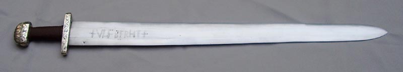

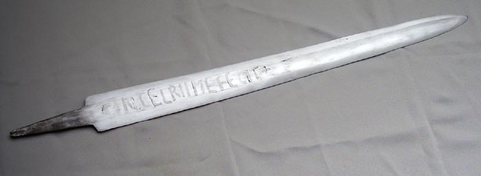

And finally some overall pictures of swords:
Attachment: 17.78 KB
The Petersen type K sword, model from the famous Ballinderry find.
Attachment: 24.58 KB
The INGELRIIMEFECIT blade. Still without a hilt.
Attachment: 60.83 KB
A Mannheim-type sword with INGELRII inscription. [ Download ]

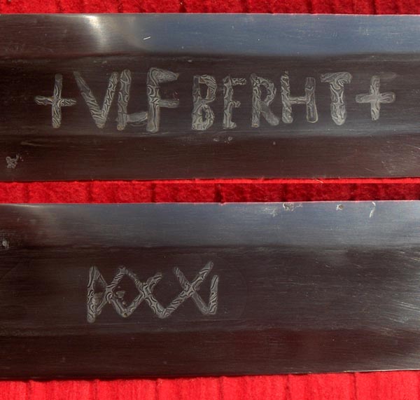

I've been quite busy lately, but still I managed to complete my commission. I made a disc-pommeled sword with +GICELINMEFECIT+ and +INNOMINEDOMINI+ inscriptions executed in higher-carbon material then the fuller (photos in the attachments). I found out that the same technique works well with both the big pattern-welded inlays and smaller iron/steel inlays. Both these can be hammered cold into a hot blade blank in such a way that the inlays sunk all the way into the blade without considerable widening. After hammering, the inlays are welded.
Still there is one modification when executing small inlays. When a large pattern-welded inlay is placed on top of a hot blade, there is circa 4-6 seconds time to carefully (and quickly) adjust the inlay into its correct position and hammer it in. Otherwise the inlaid rod will get too hot and it will only flatten when hammered. Now when smaller inlays evident in archaeological finds are placed on a hot blade, there is only about three seconds time to adjust and hammer the inlay before it gets too hot. Because of this the inlays in the pictured blade are tilted. I did not have enough time to adjust them straight. I think that this could be prevented by chiseling or punching very small and shallow guiding grooves for the inlays before hammering. In this way the inlays could be dropped into the shallow grooves and hammered more quickly.
Pattern-welded blades were sometimes decorated with inlays too. In Finland I have so far found five these kinds of sword blades, and the phenomenon is known also elsewhere in Scandinavia. One good example is pictured in Ian Peirce's Swords of the Viking Age (2002) on page 150. It must be noticed that actual inscriptions seem to be very rare; normally inlays on pattern-welded blades are some symbolical motives like figure-eights, circles, omega-like devices, lattices or plain vertical lines. One actual inscription is found in a sword from Netherlands, where iron text +ATALBALD+I is welded on a pattern-welded fuller. See e.g. Jaap Ypey: Einige wikingerzeitliche Schwerter aus den Niederlanden. Offa 41 (1984), p. 224.
The inlays on pattern-welded blades are also normally pattern-welded, but sometimes the inlaid figures are made clearer by using non-twisted rod (as in the case illustrated in Peirce's book). Twisted pattern-welded rods would probably look quite chaotic on pattern-welded surface also consisting of twisted rods.
Attachment: 52.58 KB
Attachment: 40.76 KB

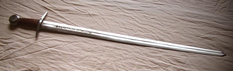

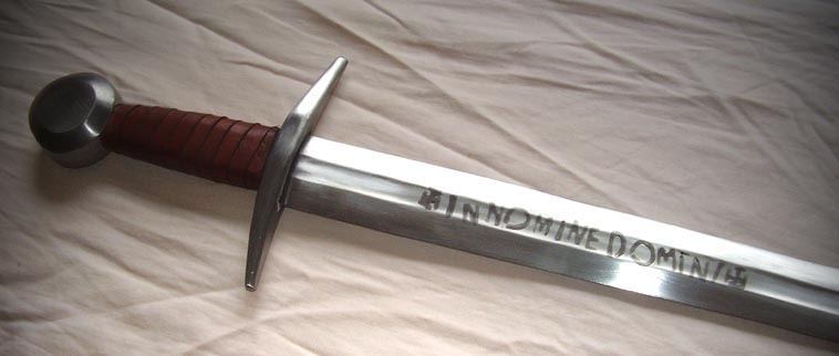

Here is an overall photo of the INNOMINEDOMINI sword, and a close-up of its inscription. By the way, the original is illustrated in Ian Peirce's 'Swords of the Viking Age' on pages 134-135.
Attachment: 26.54 KB
Attachment: 46.54 KB
