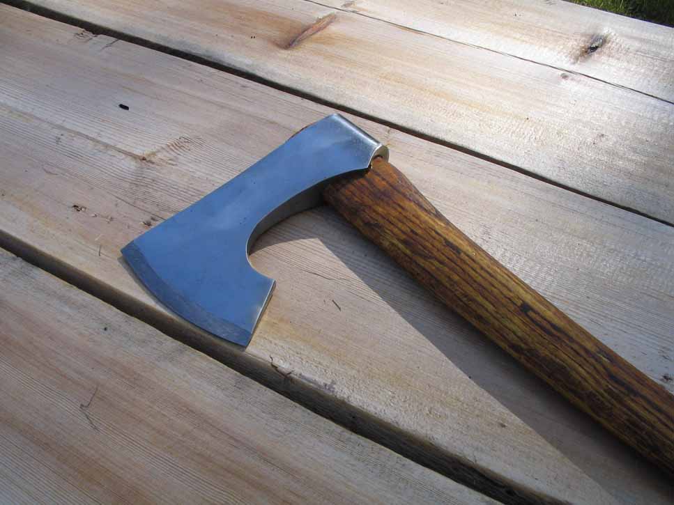

So, the bearded axe is trying to raise some viking spirit with its looks. It is 66cm long, and weighs about one kilogram. I took a little shortcut in the making process I bought a cheap, LARGE axe(I think it was about 8€) and modified it into this. I used angle grinder to cut the shape, and belt sander to clean the surface, since it was covered with paint. The handle was also lacquered, and I sanded it clean. After sanding I dyed and waxed it. The blade quality is not much to talk about. While cutting it to new shape, I revealed some hollow points that were inside the blade Guess it was welded into one piece where ever mountainside it was made...

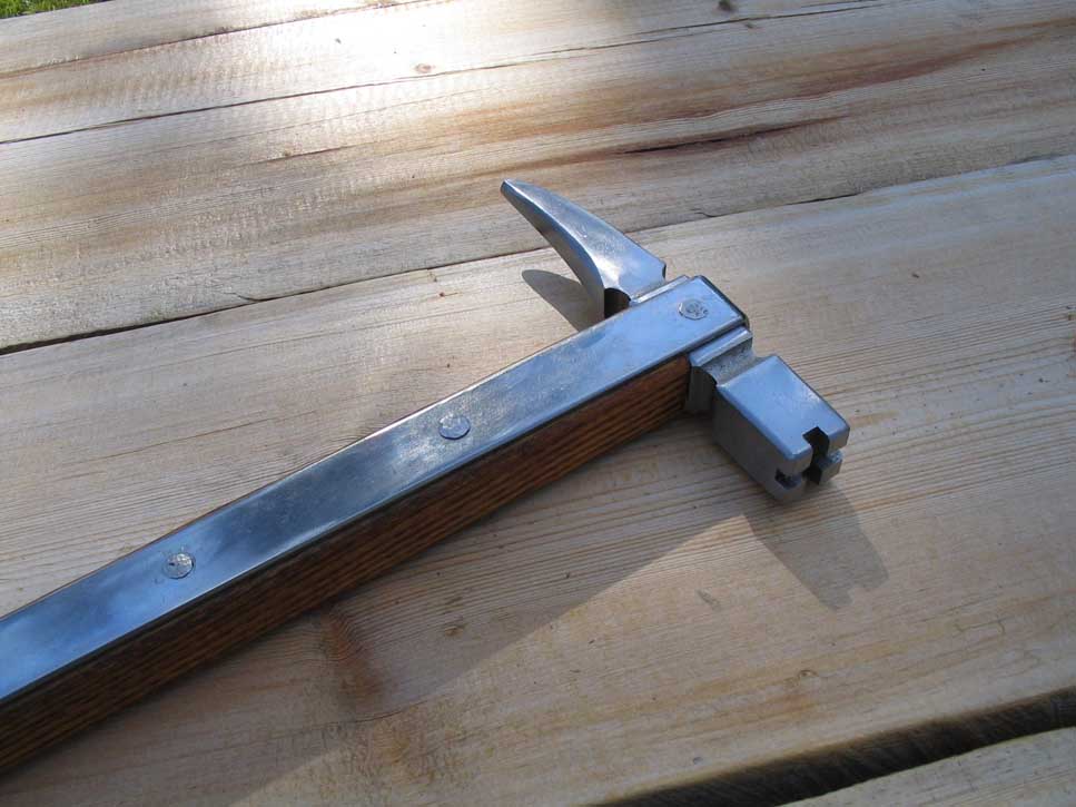

And on we go with the warhammer...Itīs 73,5cm long and the weight is maybe a bit over one kilogram(havenīt measured). The "blade" is milled and sanded from mild steel. The langets(or what do you call them?) are also mild steel, and made of one piece, bended over the "blade". "blade" is riveted into its place through the langets. The langets are then riveted through the handle with four rivets, so the structure is quite durable. Handle is dyed ashwood. I have thought if that handle should have been a bit longer, since the front part is quite heavy...

Does the shaft of the warhammer extend through the head or is it just butted on top? How was it done historically?

The shaft doesnīt go through the head, itīs just butted on top with the rivet going through. I thought about making a spike on the top, and it might have been a good idea to then install that spike through the head and into the shaft. Didnīt do it after all. The way I made it, the construction is quite strong, and there is not very much distress pointed to the shaft. The head also keeps firmly on its place.
Iīm not quite sure, is this historically how accurate, but I remember that I have seen something like this...anyway, it works just fine Wink

But you said you just bought a wood axe and reshape it into a beard axe?

If you make the edge very sharp and reduce the edge-shoulder you can hold it 'inside' the beard and get a great planing action.
As for the warhammer I really like the simple head, I'd just shape the sides of the langets? to make them more handmade-looking, or even tapered from top to bottom.

To Etienne: Yes, it was a large wood axe that I reshaped with anglegrinder.
To Michael: Thanks for the tips. I also think that I could have removed some more material from the axe and make it a bit more lighter. And itīs true that the langets on the warhammer might have needed some more shaping. Guess I wanted to finish the piece as quickly as possible...also wanted to keep it simple. The hammer is quite heavy for itīs size(I think), so the shaping of the langets might have reduced the weight also. The weight gives a good swing and powerful hit, but itīs not too quick to handle.

Can you give me the measurements of the axe head? (lenght,width and weight)

I put the dimensions to the picture attached. Hope it helps. I didn't have anything at hand to measure the weight so it will have to wait. I would call it light rather than heavy, if it helps Wink
Feel free to ask if you need more measures.

Actually it was quite easy to work with, and took maybe about 2-4 hours to finish. I grinded the basic form with a large angle grinder, and used a belt sanding machine to smooth the lines. When you do some work with an angle grinder and get familiar with it, it's actually very handy to work with.
