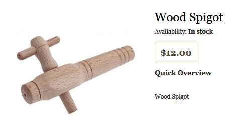

Tapping the face of a keg or the side requires a tapered hole predrilled and bunged with soft wood. The tap, as shown above is driven in with a mallet, pushing the bung into the keg. Great to dispense but how to move the thing around without dead lifting it? Your 30L barrel would be manageable by two stout lads but the larger vessels normally used in the wine and ale trade are impossible to dead lift without a crane or pulley set up. Barrels roll, that's why they didn't use boxes for liquid storage. The tap was driven only once the keg was set up to dispense.
Leaving the historical for the practical. Keep your kegs wet with clean water, use a vintners' sanitizer occasionally. Remove the tap and siphon your wine in. Sanitize the tap and seat it tightly again. Enjoy. 30L of wine is a good banquet volume. Not too expensive if you are making it yourself. :cool:

My barrels don't have holes predrilled in the face. Just the big bunghole in the side for filling it. Could I just drill a straight hole and snugly fit the tap using some cloth? That's what the copper did with the big bungholes (cork + cloth). I was smart enough to buy a couple of those wooden taps in France, but I wanted to get some more advice here before I started drilling :)

Tapping the face of a keg or the side requires a tapered hole predrilled and bunged with soft wood. |
