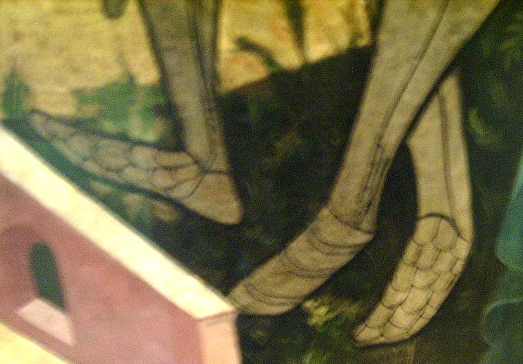

The picture that Merv Cannon posted caught my attention. When I look closely at it, the detailwork is fascinating. To my untrained eye, I can make out the weave direction of chainmail links on the collar. It almost looks to me that the scales pictured in this shot seem to be made out of smaller ringed chainmail as well. Any thoughts on this? It might make sense, combining fashion with functionality. This might be something I would like to attempt a recreation of in my spare time...
Attachment: 113.29 KB

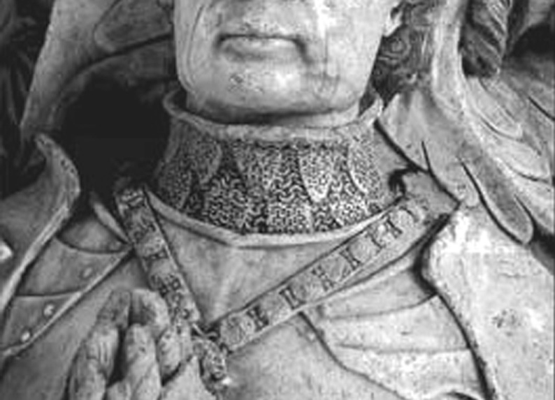

While studying effigies I came upon another Spanish effigy of an unknown knight c. 1450 in St Bartolome's in Salamanca which appears to have a scale haubergeon depicted underneath a surcoat. here is the line drawing floating around the internet
it is definitely not mail
Thanks for letting us know this Spanish piece. I've never heard of it... :surprised:
By the style of the drawing probably is related to a ilustrated magazine called "la ilustración hispano-americana", typical of the late XIX and early XX centuries...I'll try to find something more. I'm not sure if it can be scale or mail, until I find a photo. Those XIX ilustrators have some problems with the mail... ;)

I found the image here:
http://effigiesandbrasses.com/monuments/unknown_anayas/

Do you have the picture of that effigy? I couldn't find it anywhere.
I've been unable to find any mention on a paper dealing with funerary statues in Castilla y León... :confused:
The provenance of the drawing is, as it's explained in the given link, a work by Carderera y Solano, Valentín, called "Iconografía Española" not avalaible in PDF, perhaps they have got in a nearby library in paper...
About the scale coat from Vitoria...my opinion has not changed: I haven't got the knowledge to date it, but my opinion is that is nor from the 12-14th centuries, nor probably European. I'd like to hear the opinion of anyone with a deep knowledge of oriental scale armour regarding it...

Correct name:
Martín Vazquez de Arce, better known as the "Doncel de Sigüenza". Thousands of photos over the WWW, it's probably the most famous funerary statue of Spain, only behind the one of the Teruel lovers...;)
A living knight reading a book, not a very common depiction:
But I don't see any scales...even in better photos.
