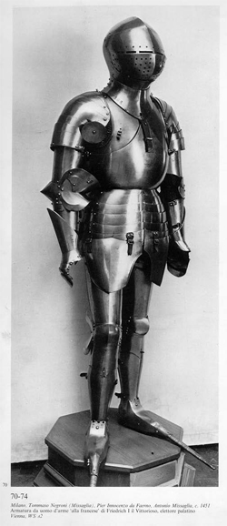

in the first pictures of Chad post
manufacturer: Antonio Misaglia - Milan - Italy. armor for men of arms. "french"
Armor of Fredrich I, Elector Palatine - Vienna
here the full armor
