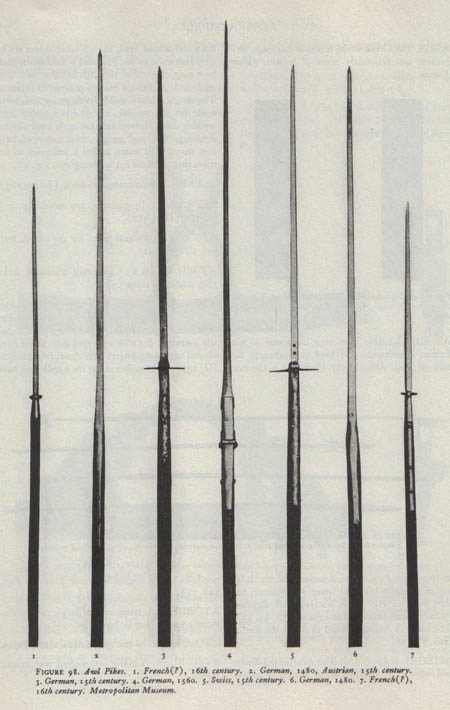

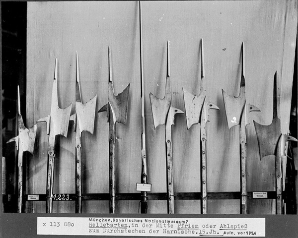

Going to make an Ahlspiess soon and digging for museum/collection photos of the wonderful Ahlspiess. These ive found so far but im interested in getting some with high resolution for more "forging details".

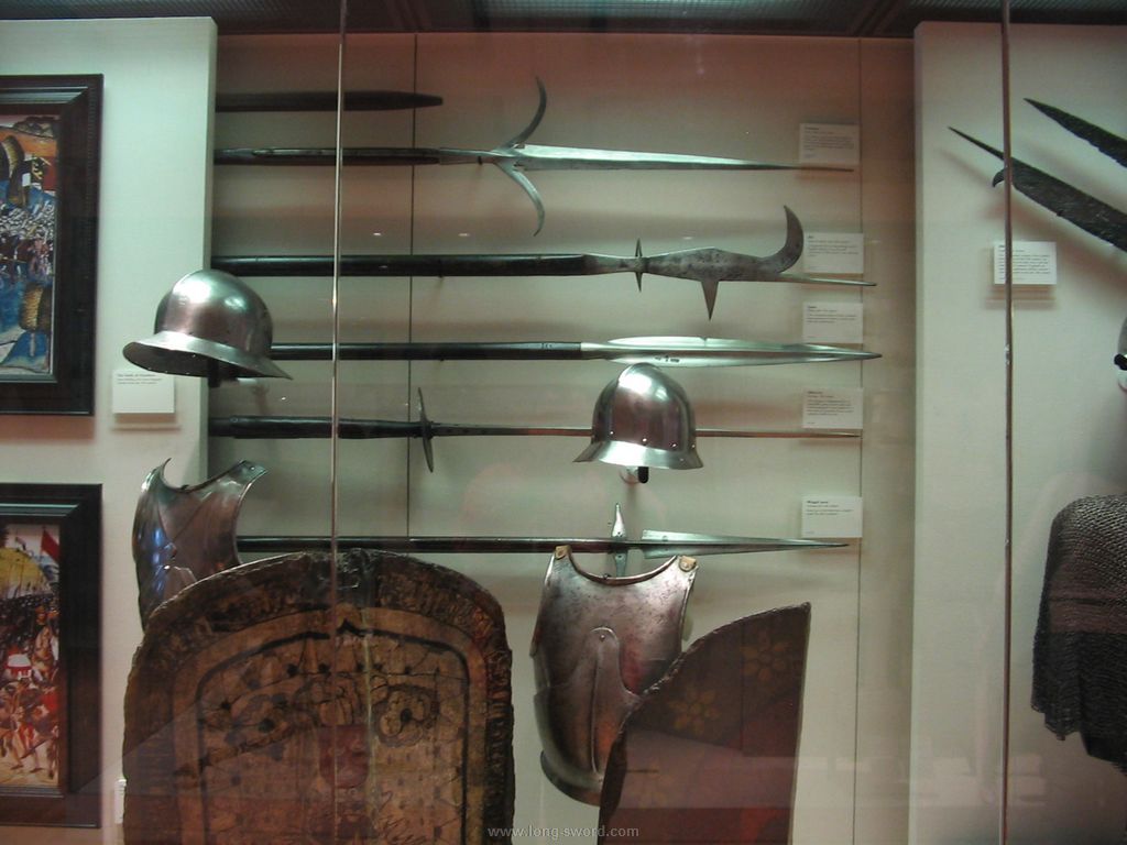

Here are some I took:
Base of an axe next to it:

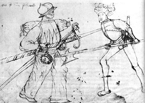

I think much of the confusion in the west is over the name, usually translated as "awl-pike" which means most people think it's a form of pike, in the sense of being 18' long, which is a formation weapon most people don't consider a personal weapon you might associate with say, a Ren Faire persona or a D&D character or something. How would you fit in your minivan? Wink
I think it's a very interesting and seemingly effective weapon, I've been waiting to see more reproductions of them. I wonder if it's a progression from the Pilum, to the Angon (which the Franks seemed to use as both a thrusting spear and a throwing spear instead of a pure javelin as it basically was for the Romans) to the ahlespiess.

I dont think 'Awl-pike' is a very good translation, since its obviously an infantery spear of quite avarage length, not to be use in a phalanx-formation but as a spear exclusivly dedicated for thrusting to combat armoured opponents.
The one i made is ca 230cm long and weighs 1,8kg, its balance is 15cm down from the rondel which gives it a good balance when held with two hands in say a low guard, with still some weight forward for the thurst.
The spear i made i wanted to fit a simple soldier, a munitions-grade weapon. So i gave myself a timelimit, four days, to do it in, to try and get some of these imperfections that you have a hard time accepting if you work it merely as a peice of art, but that i think are important to approach the feel of the time. So its not a forging-masterpeice but im pleased with the resault.
Its made fully by hand exept the basic sledging done with spring-hammer. Tool-steel 0,6%carb, hardened, tempered and handground.
The shaft is Red-beech, a type of wood found where these weapons where made originally.

Here's something else that might interest you. Waldman distinguishes between this short type and the longer versions like yours. I believe he refers to these as candeliere or something similar. The name is the same as the long, wood-hafted candles used in Europe at the time. Dürer depicts one of those candles in one of his woodcuts (with a spiral-turned haft) So, there's a bit of an infantryman's joke in calling those shorter weapons "candles". With the spiral reinforcing band(?) the weapon shown below does closely resemble the candle in the Dürer woodcut.
