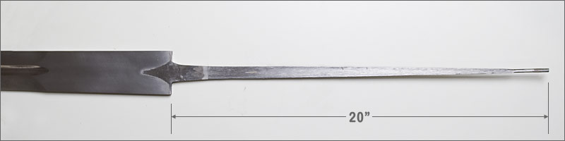

it is not a full rat tail. THe tang after the shoulder tapers in and the last inch and a half is a screw. I have contemplated shortening the sword and peening the rat tail over but am not sure how it would affect the swords handling. I also thought of replacing the pommel (which is hollow but over 1/4 inch thich) with a solid one, perhaps countering the tang loss with some added weight.

I have this sword. For what it is and at its price point, I like it. It's not a rat-tail tang. The tang on mine is fairly substantial

Here is a photo of the tang... not as substantial as I remembered... but not terrible.
Remember, the hilt is very long. The tang extends 20" from shoulder to end. The narrowest part is .25" wide. It changes from a rectangular to roughly round cross-section a couple inches from the end. There appears to be no welded section, and so it's not a rat-tail.
