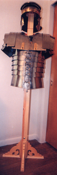

I made a nice,sturdy museum-type stand for my wife's lorica segmentata and helm. I have the full instructions and photos somewhere. I'll try to dig them out tonight and post them here.
First, I'd suggest using wood. Lighter isn't always better. Yes, the fully-loaded stand can be a pain to move (I take my wife's kit around to her university department's recruiting events), but I appreciate the stability of the piece when it's on display. Plus, the stand alone isn't all that heavy.

Mine has "shoulders" which could serve as attaching points for additional arm structures, but I'm not sure what those would look like. If you mainly just need something of arm-like diameter, I think the PVC solution would serve.
I took my cue from the antique stands in the Graz armoury. However, instead of the typical box-type base, I got four L-shaped ornamental wooden brackets from Lowe's and used them upside down at the base of the stand. I found these to be kind of flimsy, so you might want to reinforce those with screws OR cut the brackets out of thick wooden planks (simple triangles should work fine). I think the base is the most important feature as far as stability is concerned. Tipping is the great danger, and no amount of weight is going to tip the stand as long as the bases extend far enough out from the central post.

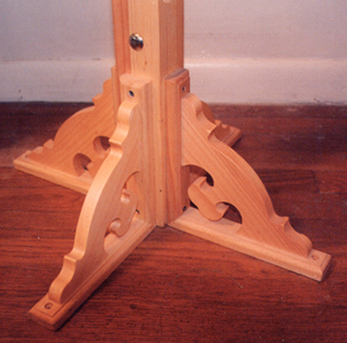

4x4 seemed like overkill for the main shaft of my design, so I used three 1x3 boards, glued them together and then used a few shiny steel carriage bolts on the shaft both for decoration and strength. The trick I figured out was to to leave the middle 1x3 short, cut off at shoulder height. Slide a shoulder width length of 1x3 horizontally into that space (shape the ends so that you have a long, flat pyramid). Then cut another piece of 1x3 to fit vertically on top of that piece and make up the rest of the difference to the top of the stand. Put a screw, NOT a bolt, into the stand and shoulder piece from the back of the stand.

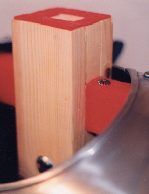

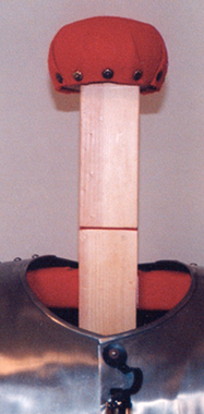

My stand has a removable helmet rest, so is constructed slightly differently. What I've described above is for a stand that includes the helmet rest. To finish the top, go to Lowes and check the craft wood section for a cylindrical piece of wood (whose intended purpose I have not discovered). It's about 2" thick and 4" across and has a bolt pre-installed so you can just drill a hole in the top of your stand and scew this thing in. It's perfect! I covered mine with felt (over a disk of close-cell foam) and used decorative furniture tacks to secure it. Alternately, go to Hobby Lobbby, Michaels, etc. and get a small circular wooden plaque. Works the same way, it's just not as robust (though you could use two of these back-to-back).
While you're running around Lowe's, pick up a good handtruck with pneumatic tires. That's the way I transport my wife's stand and armour to schools and such. You might also look into getting a '93 Toyota Corolla wagon. :lol:

Here's a nice example of the box-type base. Notice that in this case the main shaft extends to form a helm rest. The arm defenses seem to be simply resting against the tassets.

Here are some crappy scans of some terrible matte prints of some trashy images :(
The lens distortion on the full length shot makes the base look too small, but it's much better in person. Hopefully, these are mostly self-explanatory. I made this four years ago, and would do a few things differently, but the basic design is sound.

Sean-
Thanks for the pics. That's pretty much what I had envisioned through your explanation. I see what you mean about the shelf brackets - don't know how they would do under the strain of a full harness - the Lorica and helm are enough. I'm liking the helmet rest - enough security and cushion to not have it wobble off. That's a touch I hadn't really considered much. For things with leather or linnen liners, not having the stress of a post is definitely a good thing.
What I may well end up doing with at least my Hastings kit is beef up the base, and carve knotwork up the center pole and brace work. Dremels are wonderful tools...
