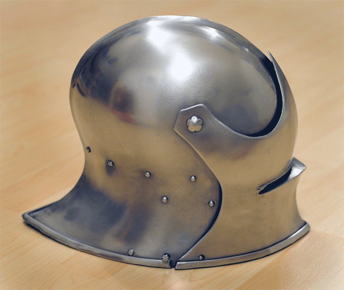

They all weight a ton :p I've had great success with this sallet helm http://kultofathena.com/product.asp?item=AB27...let+Helmet
It does feel heavy, but once I tweaked the liner with it, the weight didn't feel as bad, since all the weight was now evenly distributed around my head, rather then my forehead :eek:
What I liked most about this helm was that the eye slits were brought forward, which was accurate AND most importantly saved my eyes from getting struck with a spear during one of my demos!
Sean Flynt has done some modifications to his sallet helm. If I recall its still on sale for a very good price ;) He re did the liner completely and made it historically accurate, ground down the visor to 16guage and made the visor pin. Lots of work went into it and it looks like something a master armourer would have done :)
So with some love you can make this helmet look great!
