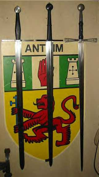

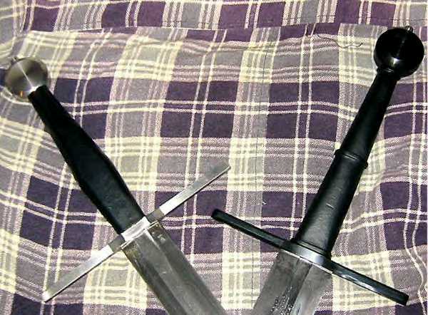

A shot of my 1319 below next to an older Gus XIIIa and the Del Tin 5157 Another with the finish difference 1999/2000 and 2003. From what I have seen of Gus' stuff. The grinds can still vary by the amount of finish time put into them.
GC
Attachment: 19.72 KB
Attachment: 51.88 KB
