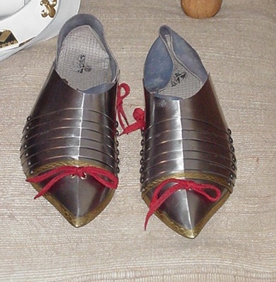

My sabatons point tie on the toe. They're almost identical to the ones pictured here in the top left thumbnail (the ones with the brass decoration). I sent him my turn-shoes and he built the sabs around the shoe.

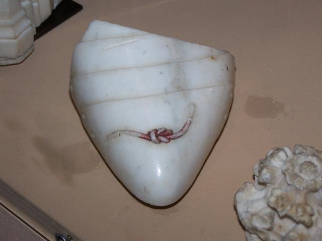

Fragment of an alabaster from Dijon showing points on a sabaton
I would imagine any shoe or low boot they felt comfortable in. Likely a side lacing shoe/boot or a slip on shoe would create the smoothest fit under tight fitting armor.
Mine are a custom pair of side laced elk hide shoes from Dru at http://medievalshoes.com/ . They lace onto the sabatons like the Dijon alabaster.
Since mine don't have a heel plate (they're styled after the ones at Chartres), Mac made them point at the toe and at the side. They work beautifully.
Whoever said above that you need a slight heel is mistaken: When I wear my spurs the strap goes under my foot and I don't even notice it, and my shoes are flat.
I have changed the shoes from those pictured to side-laced ankle shoes because I find the edge of the sabaton would gouge my ankle at the instep with the lower shoes.

I remembered that I had taken some pictures from a little more than a year ago, back when I first received my sabatons. I'll use them to illustrate what I mean more clearly. I have since then changed the shoes out for another pair - side-lacing is indeed superior here. :)
Picture 1
Picture 2
Picture 3
