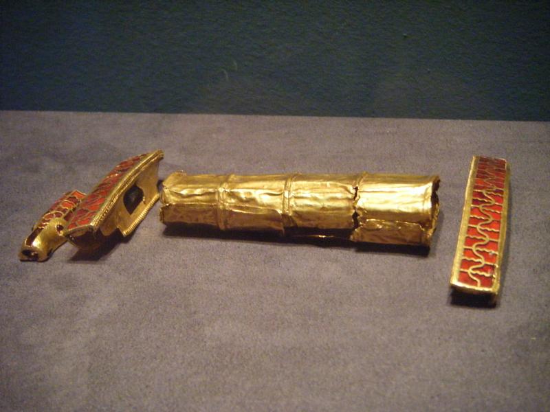

This is all as far as know, and it does involve some guesswork, but here goes:
- The pommel cap is probably hollow, and probably gold plated silver or bronze (Edit: Menghin lists the material as "gold")
- I guess the pommel cap was attached to the upper guard with hidden rivets / nails
- The guards were made of organic material, probably either wood or bone, covered with thin gold foil and cloisonné (edit: on the visible side only).
This picture, taken by Zach Luna at the exhibition "L'Epée" at the Musée de Cluny may clarify a few things.
Hi Paul, thanks for the pic, and for the info.
This pic clearly shows that the upper guard is now hollow, so it probably had an organic interior. It also shows that the upper guard is broken at both ends, so we can't tell if there were holes to allow for rivets. As for the pommel I've never seen a picture of the underside of it, so I don't know if it is solid or hollow, or if it has nails for riveting. So has anyone here ever seen the underside of the pommel on Childerics sword?

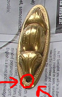

But still, if you look closely, I think I see a rivet hole close to the mouth of the beasts on the pommel (the tongue, if you will).
Also, in the picture:
"http://www.templ.net/pics-making/blucina_sword/03studying_v.jpg
I don't really see the top plate as being attached to the pommel.
Hi Paul, sorry I took so long to reply, but I wanted to wait untill I could view these images at a higher resolution.
I'm not sure what quite sure what rivet hole you are referring to here. If it's the hole in the plate itself then I dont think it has anything to do with the pommel piece, but if your referring to another rivet hole, then I'm sorry but I can't see it.
you might be right here, I'm not sure though as the image is pretty hard to see in detail.

Stephen Curtin wrote: |
I'm not sure what quite sure what rivet hole you are referring to here. If it's the hole in the plate itself then I dont think it has anything to do with the pommel piece, but if your referring to another rivet hole, then I'm sorry but I can't see it. |
See attachment. :)
