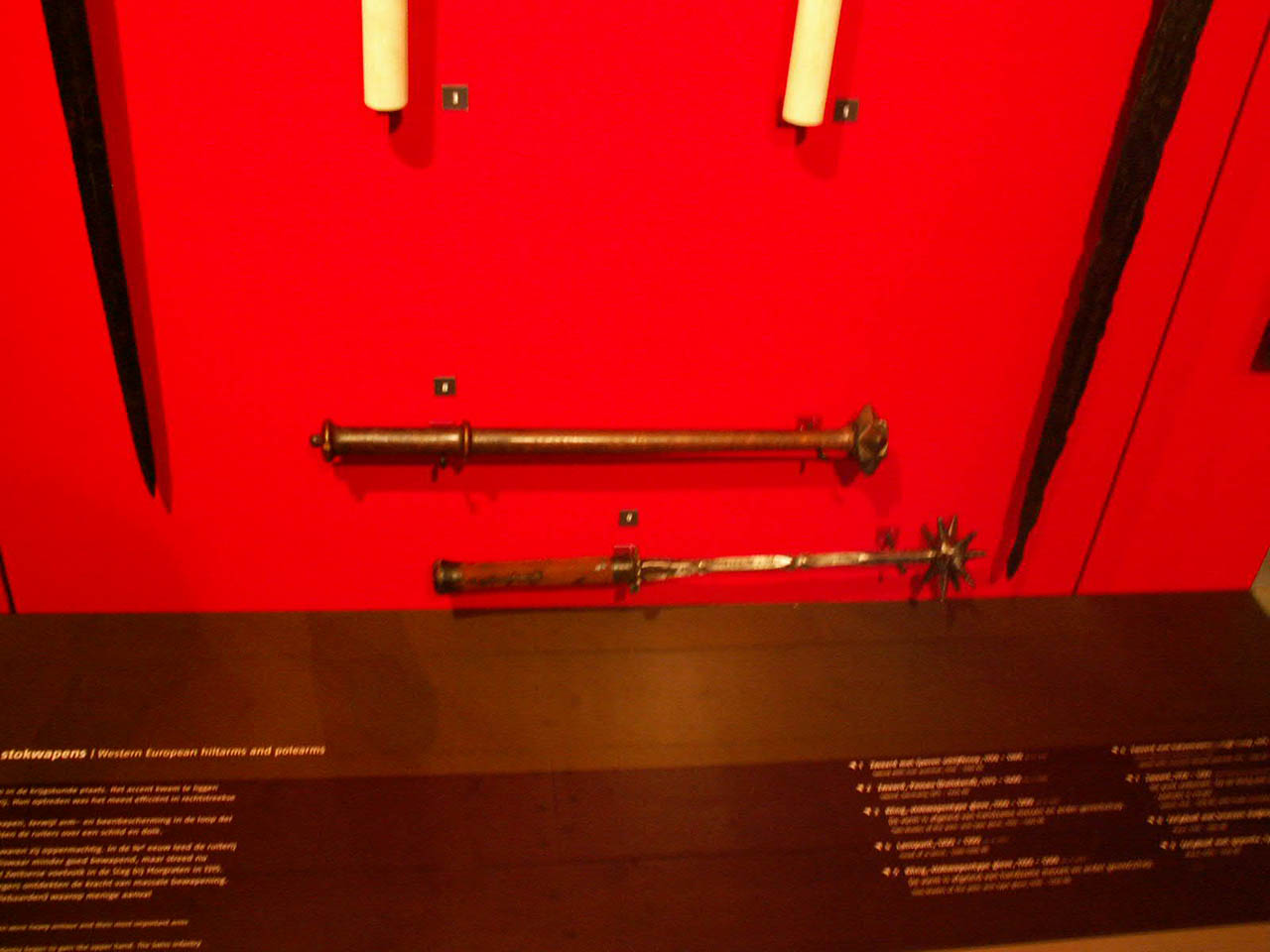

Hello Boris,
what an excellent job !!! I really like it. Attached there´s one photo I took in Legger Museum in Delft (sorry, it´s not a goot picture). Don´t you know by any chance if those original maces you posted at the top were forged or casted?
Well done :-)
Michal
