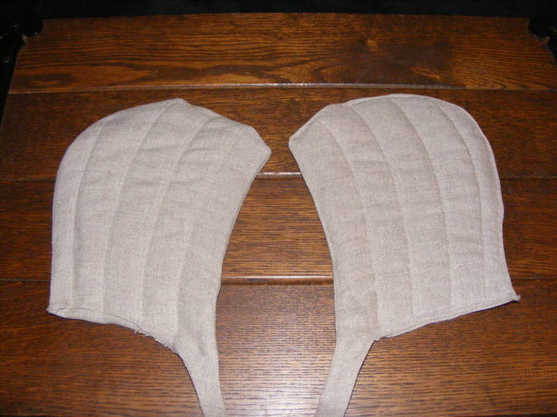

Because I had some problems with the padded coif I bought from Matuls, I decided to make my own. It's pretty much the same construction as the one from Matuls but it is much thinner and it fits me much better.

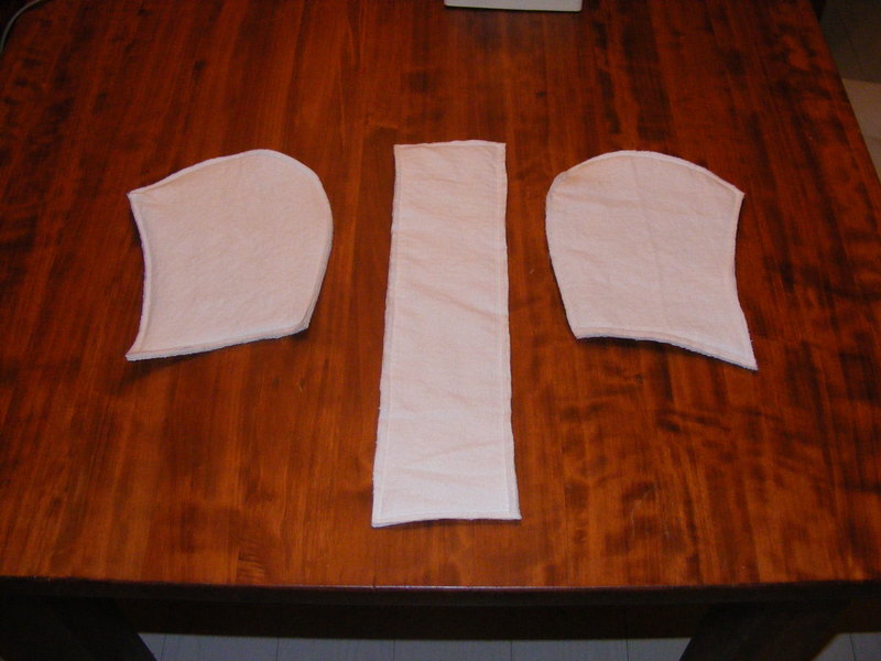

I started off with a yard or so of cotton molleton, a thick, moisture absorbing fabric usually used as a cover over mattresses. I washed it hot and put it in the dryer to pre-shrink it and make it even thicker. I used three layers of molleton for the padding, traced the design on it, sew it down and cut it out. The design of the panels was traced from a simple cotton padded coif from someone in my WMA group that fit me very nicely.

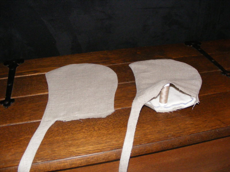

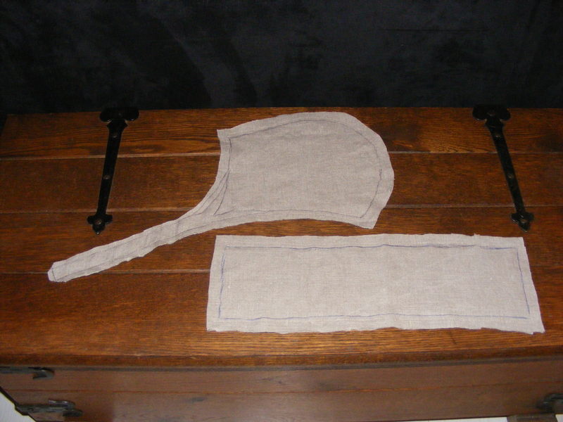

Then I created linen "sacks" or pouches to wrap around the padding. Those are simply two layers of natural linnen with the same design (slightly enlarged), sewn down on all sides except one and turned inside-out. Here are two of the linen pieces. I traced the padding onto two layers of linen and sewed about 1-1.5cm outside the tracing. I left one side open to put the padding in. One thing I did like about the Matuls design was that the straps were part of the linen that covers the sides. I did the same with my side panels.
Next I turned the pieces inside out, ironed them flat and put the padding in. On the left is a piece after ironing. The piece on the right has the padding inserted. I propped it open with a roll of twine so you can see it.

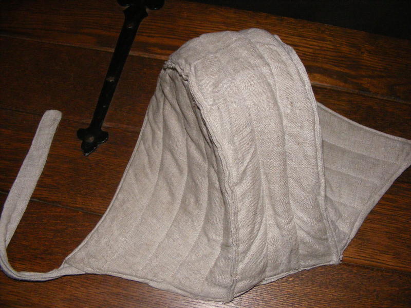

Then I sewed the vertical stitches to fix the padding in place (left), folded the opening shut and sewed all around the egde of the piece (right). The panels are done, ready to be attached to eachother.
The three panels were then hand-sewn together to make up the coif. And here's a closeup of the coif turned inside-out so you can see the seam where the panels meet.
As you can see, it fits me much better than my old coif.
All in all, I think it turned out pretty well!

I made two 2-piece unpadded coifs. I had some trouble getting the curvature right. But I did design those from scratch instead of copying piece that fit, like I did for this padded coif.

I finished the second coif last Wednesday and I remembered to take pictures. I have updated the first post in this thread to include pictured of the missing steps. I hope it's of some use!
